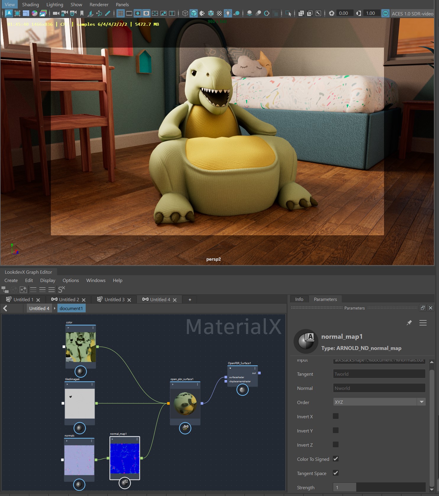

Node Previews Nodes in LookdevX graphs now have swatches that allow you to instantly see the result of any node or combination of nodes without needing to render the entire scene. As node properties are tweaked, node previews update in real time, providing live visual feedback without the need to recompile shaders or re-render. Node previews in a material graph editor enhance the usability, speed, and accuracy of shader/material development. They turn abstract data into visual cues, empowering artists and developers to make faster and more confident creative decisions.

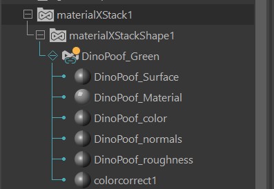

Loading MaterialX Documents MaterialX documents can now be loaded into your Maya scene. Loaded documents retain a link to the original MaterialX file on disk so edits performed in LookdevX can be saved out to the file which lives outside of Maya. New preferences have been added for controlling the behavior of how MaterialX docuemts are saved and loaded documents are indicated by a new icon in the Outliner that alerts you to when the document has unsaved changes.
