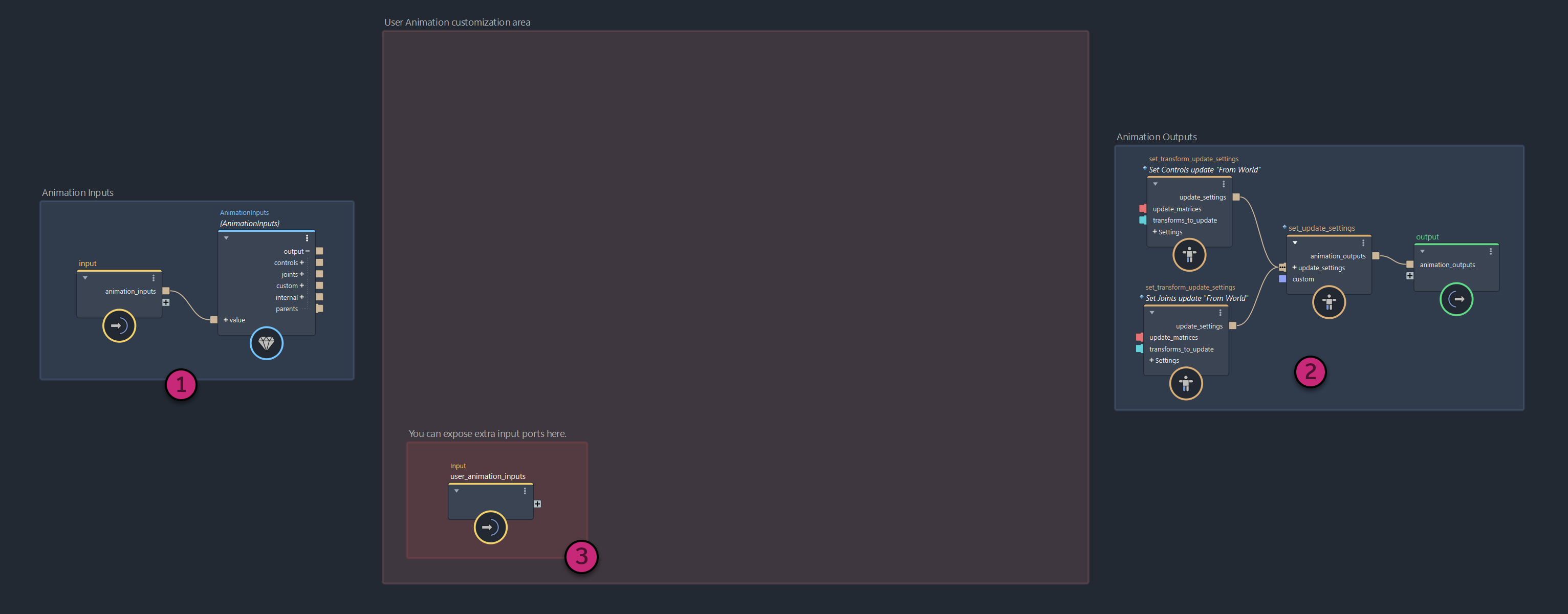

The user_animation layout includes:
  • AnimationInputs (1): A struct containing all control and joint data, along with any custom setup or animation data. This node provides direct access to the raw data, and is not required for most workflows. In many cases, it can be deleted.
  • set_update_settings (2): A node where you can connect set_transform_update_settings nodes in order to schedule control and joint transform updates.
  • user_animation_inputs (3): An input node to expose parameters at the top level of the module so that you can control your user_animation logic from there. You can create multiple input nodes as needed.

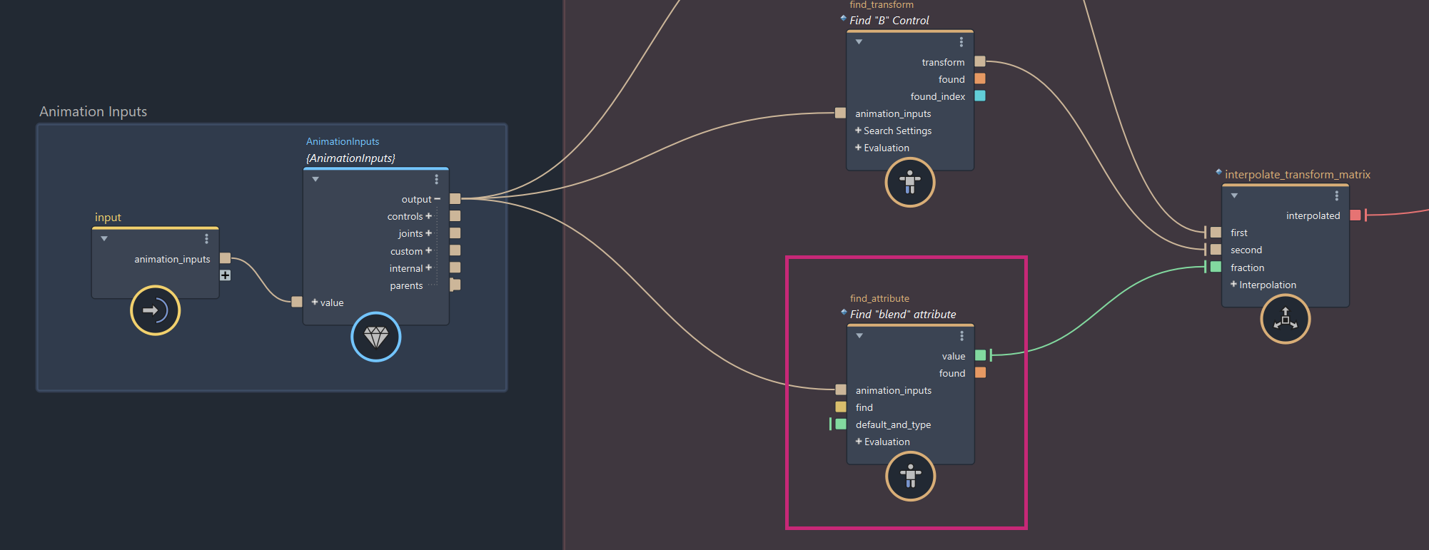

Although you can access the raw data directly, the recommended way to retrieve attribute values is by using the find_attribute or find_all_attributes nodes.
Connecting animation data
To start, connect the output port from the AnimationInputs struct to the animation_inputs input of each find_attribute or find_all_attributes node you intend to use.
Alternatively, you can use the animation_inputs port on the input node directly if you don't need to access raw data from the AnimationInputs struct.
Start by defining the data type of the attribute you want to query. To do this, right-click on the default_and_type port of find_attribute and set the type under Value Types.
Then, use the find port to specify which attribute to retrieve. This input accepts a search expression that filters attribute names. The search supports wildcards (*) and negation (!). For example:
  • "*blend*" will match any attribute whose name contains "blend"
  • "weight*" will match any attribute whose name starts with "weight"
  • "*blend* !*weight*" will match any attribute whose name contains "blend" but not "weight"
  • "weight" will match any attribute named exactly "weight"
The first attribute matching the type and the expression is returned by find_attribute , while find_all_attributes returns all matches as an array.

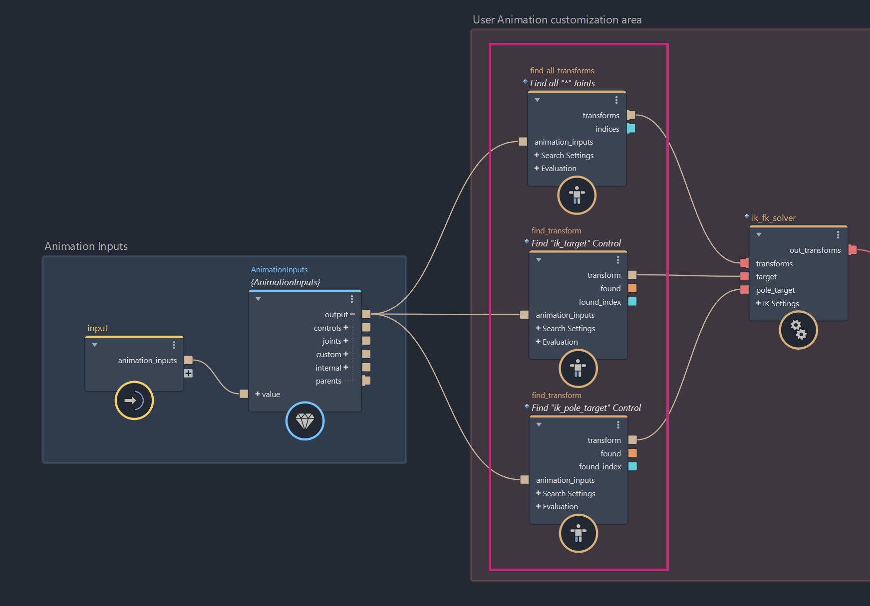

To access the transforms of the entities defined in your module, the recommended method is to use the find_*_transform nodes.
These nodes let you search controls and joints by name or tag, and return the transform and relative index for the matching entities.
You can use find_transform to get a single control or joint transform, and use find_all_transforms to retrieve an array of control or joint transforms. Alternatively, you can use find_upstream_transform and find_all_upstream_transforms to query transforms from connected upstream modules.
The returned transform(s) is of type Core::Transform::Transform. You can access the individual transform matrix components using the access_transform_matrices nodes.

First, set the kind to indicate the type of entity you want to search for. This should be either Control or Joint.
Next, set the search_method to determine how the control or joint will be searched. You can choose to search By Name or By Tags.
When using the By Name method, the find string is interpreted as a search expression that matches control or joint names. Wildcards (*) and negation (!) are supported. Examples:
  • "foot" will match the first transform named exactly "foot"
  • "leg_*" will match the first transform whose name starts with "leg_"
  • "*hand*" will match the first transform whose name contains "hand"
When using the By Tags method, the find string is interpreted as a comma-separated list of tags. This is useful when you want query entities without relying on specific names. For example, specifying "root, anchor, hook" will search for a entity that matches one or more of those tags.
  • If find_all_tags is disabled, the first transform containing any of the listed tags will match.
  • If find_all_tags is enabled, the first transform containing all of the listed tags will match.

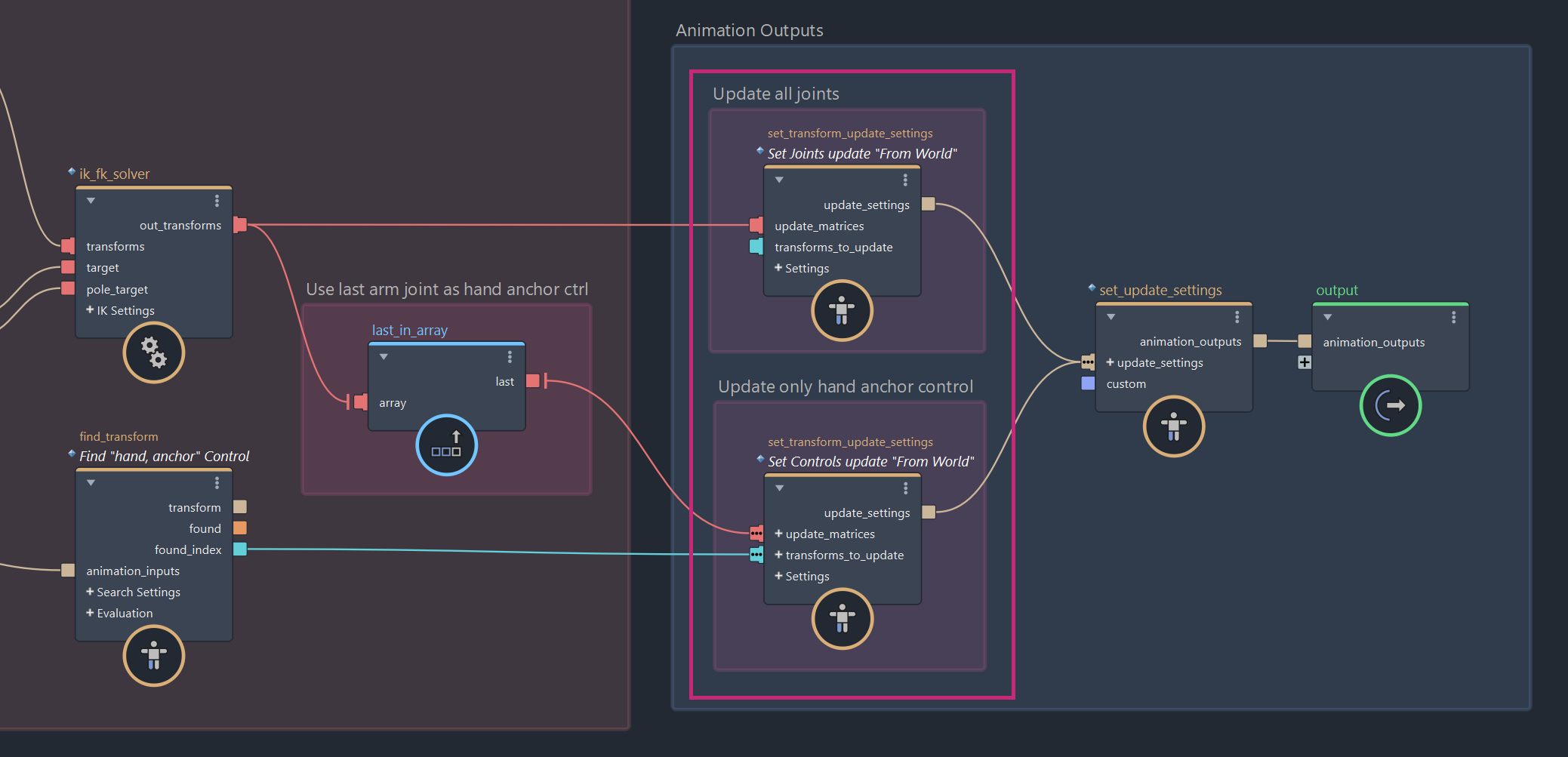

To apply transformation results to controls or joints, use the set_transform_update_settings node to build a set of update instructions.
If you want to update all controls or joints at once, you can leave the transforms_to_update input empty and connect an array of matrices to the update_matrices input, assuming the array matches the target entity count, and its ordering.
If you want to update only a subset of transforms or apply matrices out of order, in addition to the update_matrices, you must provide the correct indices in the transforms_to_update input. Each index corresponds to the index of an entity as returned by the find_transform or find_all_transforms nodes.
The way update_matrices are applied depends on the update_method parameter, which defines both how the matrices are interpreted and which component of the transform they will update. Available methods include From Pivot, From Operator, From Local, and From World.
When the update settings are ready, connect the output to the set_update_settings node. Multiple update settings can be connected in sequence and will be applied in the order they are received during evaluation.

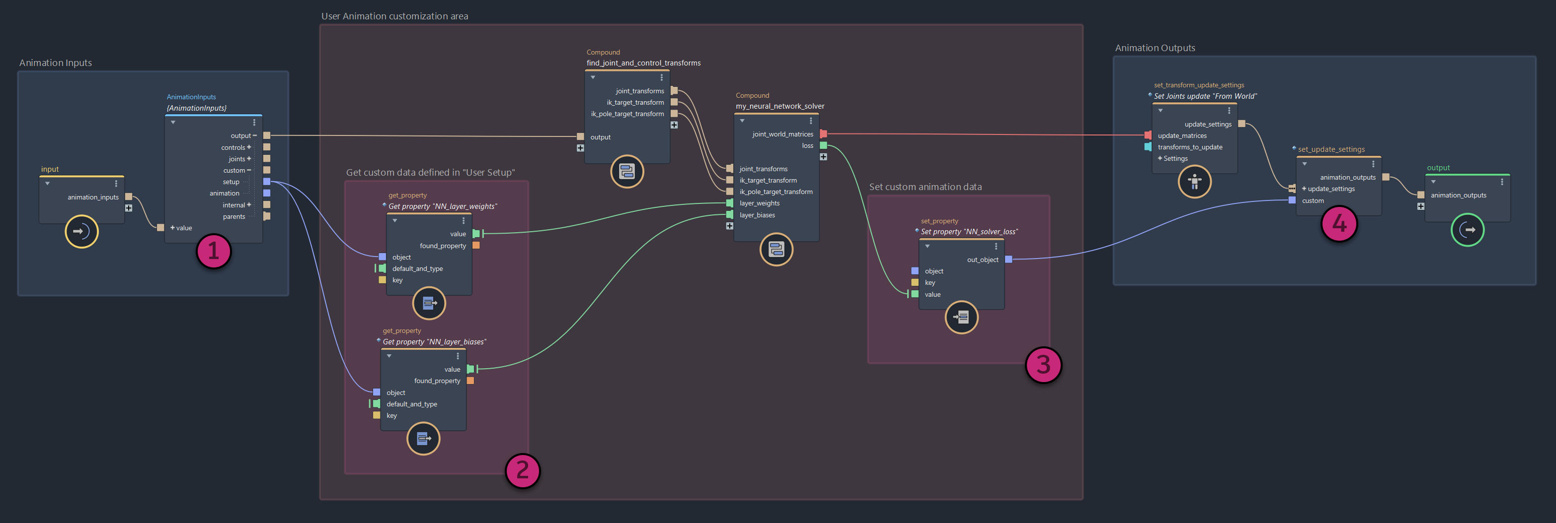

The example below demonstrates how to access custom setup data defined in the user_setup sub-compound, and create custom animation data from the user_animation logic.
Custom setup data is accessed from SetupInputs.custom.setup (1) using get_property nodes (2), in this case, this is used as layer weights and biases for a neural network solver. The solver's computed loss is stored using a set_property node (3), then passed to custom port of the set_update_settings node (4) so that is can be accessed outside of this module.
example of using custom animation data
This is just one example. The same workflow can be used to handle any kind of custom data.
