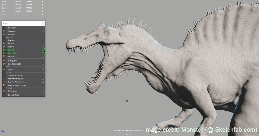

If you have a mesh that's shaped to your liking but has bad topology (uneven faces, n-gons, etc), you can use the Remesh and Retopologize commands to fix the entire mesh and avoid painstaking manual modeling labor. Use this method when you want to uniformly retopologize an entire mesh at once.
Each of these commands can also be run individually, though they are typically run in sequence.
To retopologize a mesh
