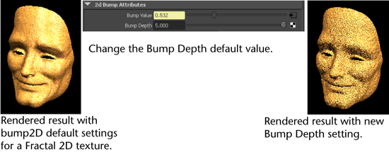

- Bump Depth
Controls how high the bumps display on the surface. Increase Bump Depth to make the surface bumpier. Decrease Bump Depth to make the surface smoother.
You can achieve almost identical effects by adjusting the Bump Depth or the Alpha Gain and Alpha Offset of the texture. The Bump Depth is determined by reading the alpha gain value of the texture. Both controls can be useful in complex shading networks where there may be multiple bumps. The alpha gain attribute lets you individually adjust the bump for each texture.
