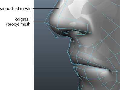

The Subdiv Proxy smoothing method smooths the selected mesh by adding polygons and placing it inside the original, non-smoothed mesh (the proxy).
When you create a subdiv proxy, the smoothed and original versions of the mesh can be displayed simultaneously. By default, the original mesh appears partially transparent so you can view the smoothed mesh underneath.
The meshes are linked by their construction history, so any edits you make to the proxy's shape or topology are also reflected on the smoothed version of the mesh. You can reshape and animate the original mesh (the proxy) and see the results on the smoothed mesh.
