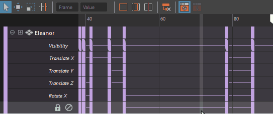

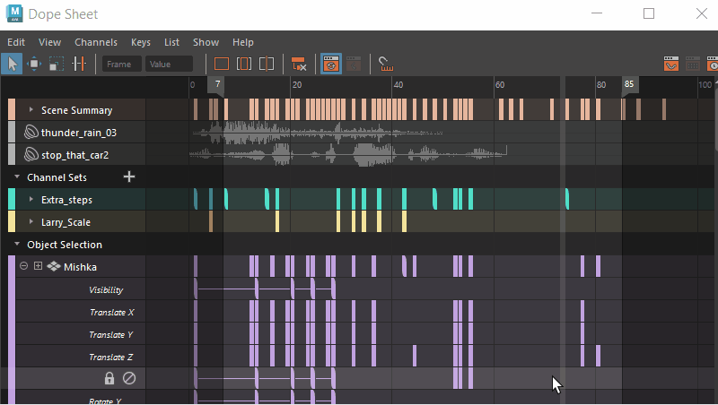

The Dope Sheet Editor gives you an easy way to work with dense keyframes, letting you make large scale timing edits.
The Dope Sheet Editor (or Dope Sheet) complements the Graph Editor by letting you make large scale timing adjustments to your scene. Unlike the Graph Editor, where you can tweak individual keys on curves, the Dope Sheet Editor lets you easily edit larger sections of animation. For example, pushing animation to start later or slowing down a rotation channel
Use the Dope Sheet to manipulate key times, shown as colored rectangles in the View area. These rectangles represent time units along the horizontal axis. The vertical axis represents the items currently loaded into the Dope Sheet outliner.

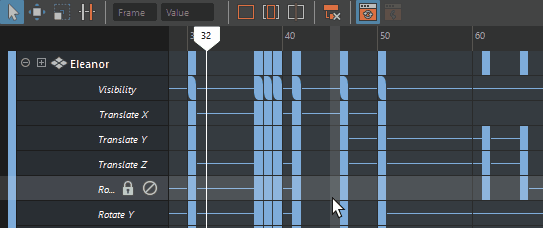

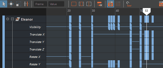

The following table provides an overview of basic tasks using the Dope Sheet. Many navigation shortcuts are the same as in the Graph Editor. For more information about editing with the Dope Sheet, see Edit keys using the Dope Sheet.

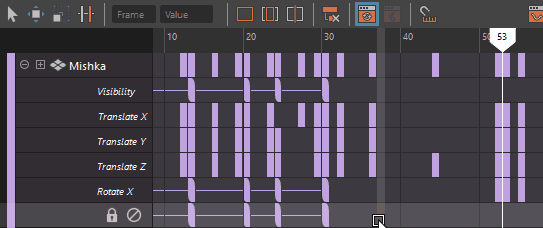

| Pan in the Dope Sheet View area |
![]() Alt + middle-drag. |

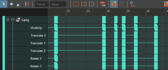

| Move keys |
![]() Select keys and use the
Move Tool
Double-click the
Move Tool

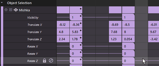

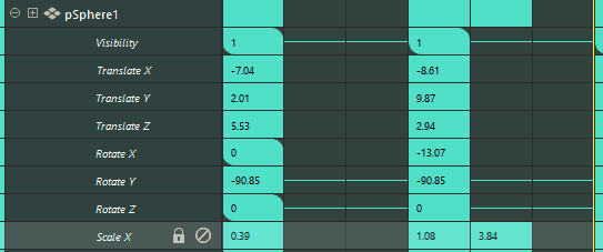

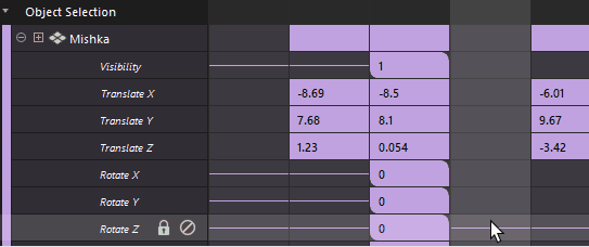

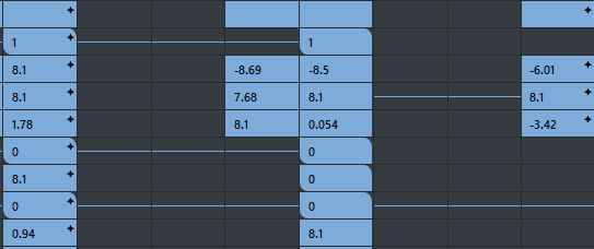

| Edit key values |
![]() Double-click a key to enter a new value. Show or hide key values using Show key value in the Dope Sheet View menu. To set the same value for multiple keys at once, Shift-select multiple keys, then Shift-double-click one of the selected keys and enter a value. ![]() |
| View subframes | Hover over a subframe (starred) key to view the subframe Time and Value.

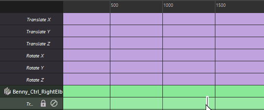

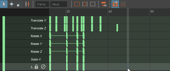

| Lock or Mute a channel |
![]() Click the Lock icon
Click the Mute icon

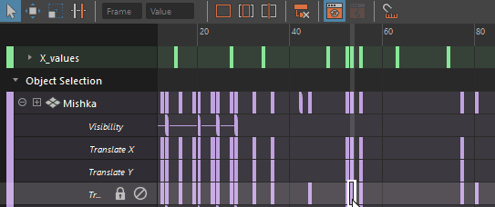

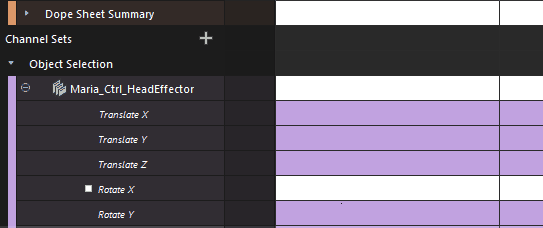

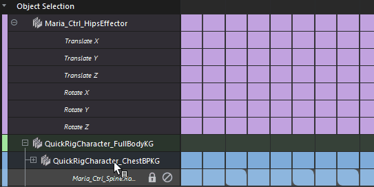

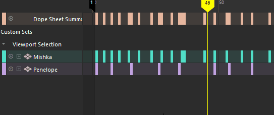

| Create a Channel Set |
![]() Right-click the + next to the Channel Set header in the outliner to create an empty Channel Set, or right-click the name of a channel in the Dope Sheet Outliner and select . See Create Channel Sets in the Dope Sheet for more. |
| Add to a Channel Set |
![]() Select one, or Shift-select multiple attributes in the Dope Sheet Outliner and middle-drag them into the Channel Set. |

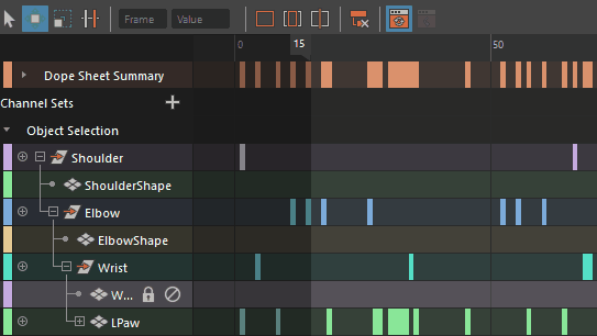

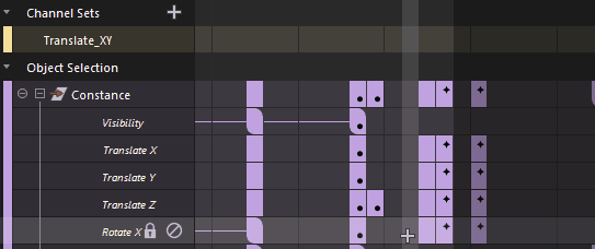

| Expand key structure |
![]() to expand the level under a node and click the plus in the circle
to expand the corresponding attributes.
| Show child keys with the parent | Click
Hierarchy Below
on the
Dope Sheet Toolbar.
