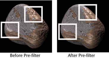

Pre-Filter
The Pre-Filter and Pre-Filter Radius attributes are used to correct file textures that are aliased or contain noise in unwanted areas. This can be very useful when displacement mapping.
When on, the image file is pre-filtered to cancel out noise and aliasing which helps provide better quality results, particularly for bump maps. Pre-Filter is off by default. Turn it on to enable the Pre-Filter Radius attribute.
Pre-Filter Radius
Determines the size of the filtering radius. The default value of 2.0 works for most images, but you can increase the radius to provide even smoother results.
