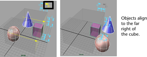

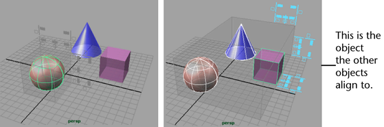

- Align Tool
- Lets you align objects visually by clicking icons representing the planes and positions you want to align.
- Select the objects you want to align. The other objects align to the last selected (green) object.
- Click an icon to align the objects. The icons show how the bounding boxes align. For example:
- Use Edit > Undo or press z to reverse an align.
In the following example, the objects align to the far right of the cube outside the transparent box.
See also Align objects.
