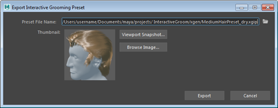

Save interactive grooms as presets
  1. In the Interactive Grooming Editor, select the description you want to save as a preset.
  2. Select Description > Preset > Export.
  3. In the Export Interactive Groom Preset window, click the browse icon to save the preset to a specified location.
    By default, preset files get saved to the xgen directory of your currently set Maya project.
  4. In the File Save window, type a name for the preset beside File Name, and then click Save.
  5. (Optional) Add a thumbnail image to identify the preset in the XGen Library by doing one of the following:
    • Click Viewport Snapshot to create an image from current scene view.
    • Click Browse to locate an image file.
  6. Click Export.
