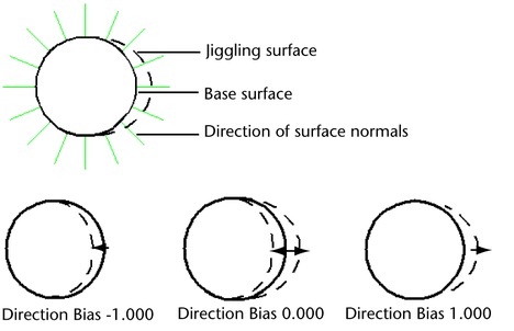

Direction Bias
Sets the direction of a surface’s jiggle relative to the direction of its normals. A Direction Bias of 1.000 causes a jiggle deformed surface to move only in the direction of its normals and a Direction Bias of -1.000 causes a jiggle deformed surface to move only in the opposite direction of its normals. A Direction Bias of 0.000 causes the jiggle deformed surface to move in both directions. The default Direction Bias value is 0.000.
You can use the Direction Bias attribute to prevent any unwanted collapsing of a jiggle deformed surface. For example, if you are animating the jiggly stomach of a sumo wrestler, you can set the Direction Bias attribute’s value to 1.000 so that the surface of the character’s stomach will only jiggle outward.
