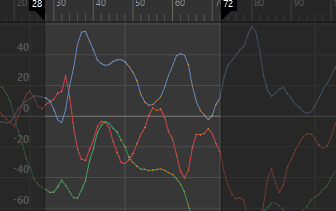

Time Range
Specifies the time range where the curve is simplified.
All
Simplifies the curve for the entire time range.
Time Slider
Simplifies the curve for the time range defined by the Playback Start and End times of the Time Slider.
Start/End
All keys within the specified time range (start time/end time) are simplified.
Start Time
Specifies the start of the time range. This is available only if Start/End is on.
End Time
Specifies the end of the time range. This is available only if Start/End is on.
Simplify Method
Set one of the following options:
Classic
Removes excess keys using the algorithm used in previous versions of Maya. Use this method on light data sets, such as keyframe animations, which don’t have keys on every frame.
Dense Data
Removes excess keys using an algorithm designed for dense data sets, such as motion capture data, which have a key on every frame. This method may also work well if the Classic method doesn’t give you the desired results.
Time Tolerance
The amount (in seconds) that the timing for the keys is averaged when the selected curve is simplified. The higher the Time Tolerance, the sparser your keys and the less your resulting curve resembles the original curve. The default Time Tolerance is 0.05.
Value Tolerance
The amount (in your current working units) that the values of the keys are averaged when the selected curve is simplified. The default Value Tolerance to 0.01.
