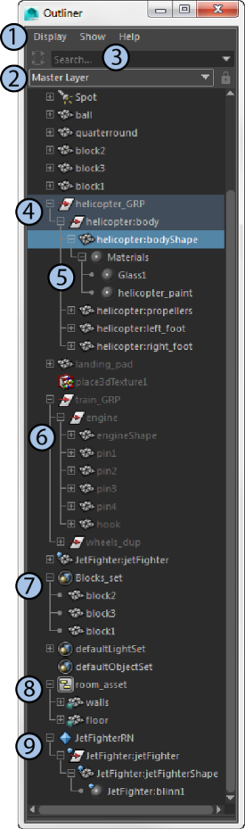

What's What in the Outliner window
Use the table to understand each numbered area of the annotated graphic:
| Element in Outliner | Lets you do this |
1 Display and Show menus |
Filter what's displayed in the Outliner - see Outliner menus. |
2 Render Setup filter |
Filter the objects in the scene by which render layer they're in - see Filter and display only render setup members in the Outliner. Choose to display this filter. You can also right-click an object's node to open the Render Setup menu and choose commands that Identify the collection to which your object belongs. |
3 Search field |
Search for any node in the scene - see Search for nodes. |
4 Groups and hierarchies |
Create and change a hierarchy of nodes. You can create hierarchies by middle-dragging child nodes under parent nodes. Middle-drag nodes within a group or hierarchy to change their order. |
5 Materials |
Display and work with materials and shaders - see the Material node commands in Outliner contextual menus . |
6 Hidden objects |
Select objects that are hidden in the view panel. Press H to toggle their visibility. |
7 Sets |
Edit set memberships - see Create and edit sets. |
8 Assets |
Work with Assets. Right-click Asset nodes to open the Asset menu. |
9 Referenced files |
Work with File Referencing. Right-click reference node or an empty area in the Outliner to open the Reference menu - see Outliner contextual menus. You can also right-click a node that you want to export as referenced file and set its options - see Export Selection as Reference Options. |
Scene Assembly |
Work with a Scene Assembly. Right-click an assembly node to open the Scene Assembly menu - see Outliner contextual menus. |
