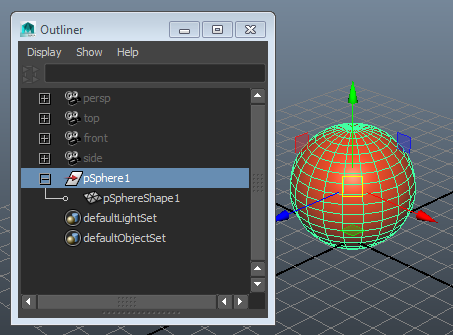

When you create a polygon sphere, for example, you can see in the Attribute Editor that it includes a shape node and a transform node. The shape node has attributes to define the geometry, while the transform node contains attributes that control the sphere's position, scale, or rotation. The shape node is the child of the transform node.

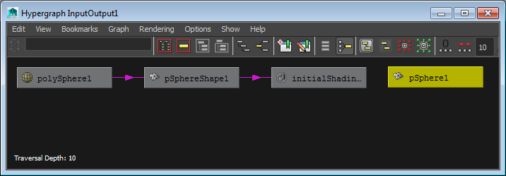

You can also view the DAG information in hierarchy form in the Hypergraph window.

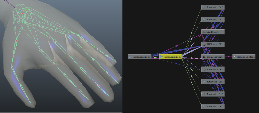

- Transform nodes contain transformation information (translation, rotation, scale) as well as parenting information. Transform nodes can have multiple child nodes grouped underneath them. Node grouping allows the same shape to be shared among multiple DAG paths. (A DAG Path represents the hierarchical links between nodes, defining the direction from the beginning of the hierarchy down to the furthest node).
For example, if you model a hand and you want to apply a single transformation to rotate the palm and fingers (rather than rotating each individually), you can use a common parent transformation node for the palm and fingers.

You can also see the DAG hierarchy at work when you open the
Outliner window and select
DAG Objects Only
