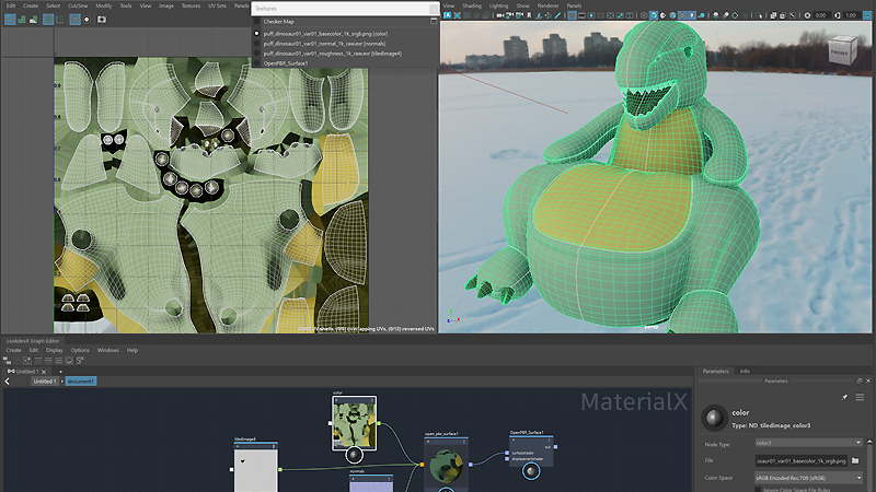

Color Management Improvements
  • The Document, NodeGraph and Node Color Space of a MaterialX document is displayed in the Info tab inside of LookdevX.
  • New MaterialX documents will now have their color space set to ACEScg by default, or follow the rule set in the Color Management preferences.
  • If "Raw" is set as the color space, the value saved inside the MaterialX/USD document will be "none".
  • Color space handling has been improved.
