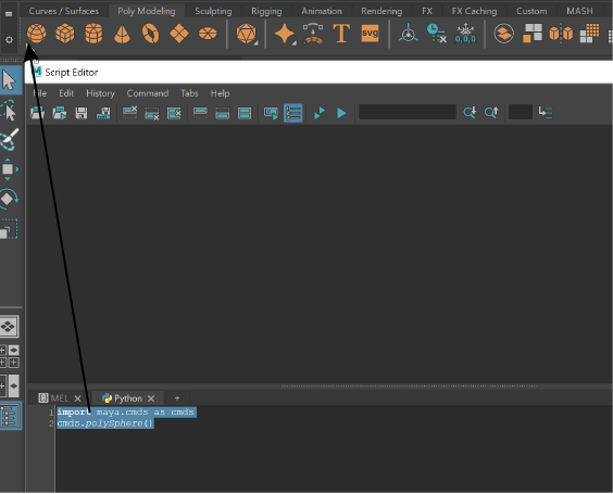

Script Editor
To facilitate having both MEL and Python scripting at the same time in Maya, the Script editor has been modified to have separate tabs for each language. Statements entered into the MEL tabbed window are sent to MEL to be processed; similarly, statements entered into the Python tabbed window are processed by Python.
Returned results from Python come prefixed with the Python comment character (#).
You can enter commands directly in the tab, or you can load an existing .py file into the tab.
In the script editor, you can use auto-completion to help you find command names more quickly. For more information, see Get help on a MEL command.
For more information, see Script editor.
Command line and Shelf
You can also enter short Python commands into the command-line. A toggle allows you to enter either MEL or Python commands.
You can middle-drag Python scripts to the Shelf, just like MEL scripts.
