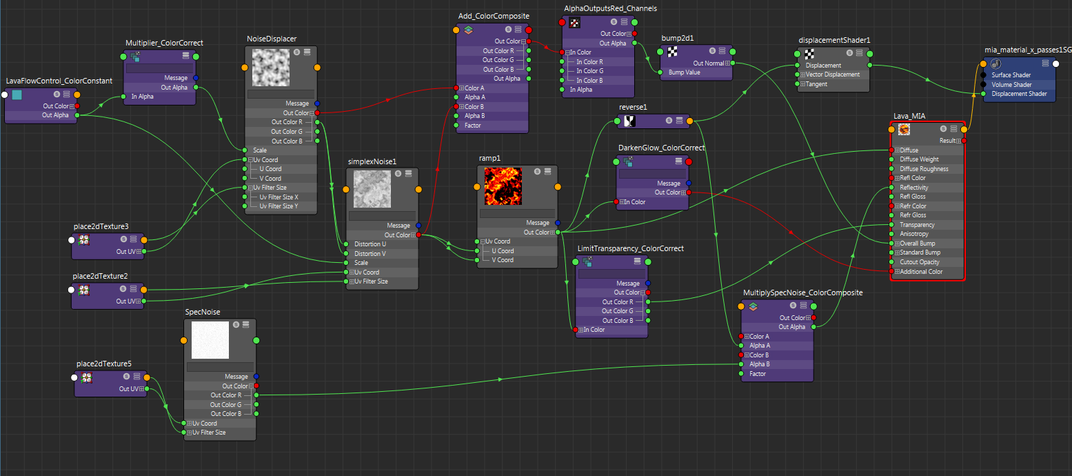

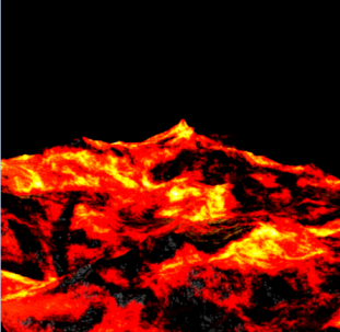

Example shader network: lava
The following shader network creates a lava material and uses the following Lookdevkit nodes:
  • Simplex Noise
  • Color Constant
  • Color Composite
  • Color Correct
Note: The mia_material_x_passes shader from the 3rd party renderer mental ray is used in this example, courtesy of NVIDIA.
Diffuse
To create the diffuse color, a Simplex Noise is created and its Out Color R channel used to drive the Distortion U and Distortion V of a second Simplex Noise, while the alpha channel of a Color Constant drives the Scale attribute of the two noises. Having one noise node distort another creates a more organic, realistic pattern, while having one Color Constant drive two Scale attributes means you have one less control to be concerned with. The Scale attribute determines the frequency at which the noise pattern is repeated.
The result of the second noise is then connected to the Uv Coord input of a Ramp to drive the selection of the colors along the ramp using the values of the noise. The Ramp color values are all set to greater than 1 to give illumination, which simulates lava in real life. This Ramp result is used as the diffuse color for the mia_material_x_passes shader.
Bump and displacement
The first and second noise nodes are added using a Color Composite node to create a more complex bump effect. The red channel is used to create the bump pattern. A Channels node is created, where its Alpha channel outputs the Red channel. This node is convenient as it allows you to use a color output instead of an alpha. This Alpha output is then used as the Overall Bump of the mia_material_x_passes shader via the bump2d node.
To create realistic displacement for a lava material, the black areas of the ramp, representing the cooled lava rock, should be the most elevated part of the surface. The Ramp output is therefore reversed using a Reverse node so that the black areas are the highest points of the surface, and connected as a displacement material to the mia_material_x_passes shader.
Reflectivity
To add realism to the lava, its black areas should be reflective, as it is cooled lava rock. Similar to creating displacement, the reversed output of the Ramp is used again in this case. To add additional interest to the specular, it is multiplied by another Simplex Noise using a Color Composite node. The specularity of shiny objects, for example metals, has a dense noise pattern, and the Simplex Noise allows you to create that pattern by adjusting the scale attribute without tiling artifacts. The alpha output of the Color Composite node is input to the Reflectivity attribute of the mia_material_x_passes shader.
Glow
To add an additional glow, the Ramp result is darkened with a Color Correct node and connected as an input to the Additional Color attribute of the mia_material_x_passes shader. The additional Color Correct node enables you to darken only the amount of glow of your output shader and nothing else. If you had instead changed the color of your ramp, all of your other attributes (Diffuse, Reflectivity, and so forth) would also have changed.
Transparency
Similarly, you can create a Color Correct node to adjust only the transparency attribute. Connect your Ramp output to the Color Correct node, then connect the Out Color R attribute of the Color Correct node to the Transparency input of the mia_material_x_passes shader.
Proceduralism
Your complete shader network is controlled by your noise node. To change the pattern of your lava, change the noise type of your Simplex Noise and all of your downstream nodes update as a result.

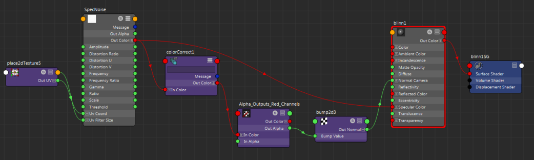

Example shader network: plastic
In this example, a realistic looking plastic grey material is created by using the Simplex Noise node to create a bump pattern.
The Simplex Noise node is connected to a Color Correct node. The output of Color Correct is input to a Channels node, which outputs the red channel as alpha (Channel A is set to R). This alpha output value is used as the bump map for the Blinn shader.
To adjust the depth of your bump, adjust the Color Gain of your Color Correct. This network allows you to precisely control the amount of bump in your shader by inserting a Color Correct node in between the Out Color of Simplex Noise and the bump 2d node to keep the bump input separate from the specular input. Otherwise, any adjustments you make to the bump attribute also applies to the specular attribute.
