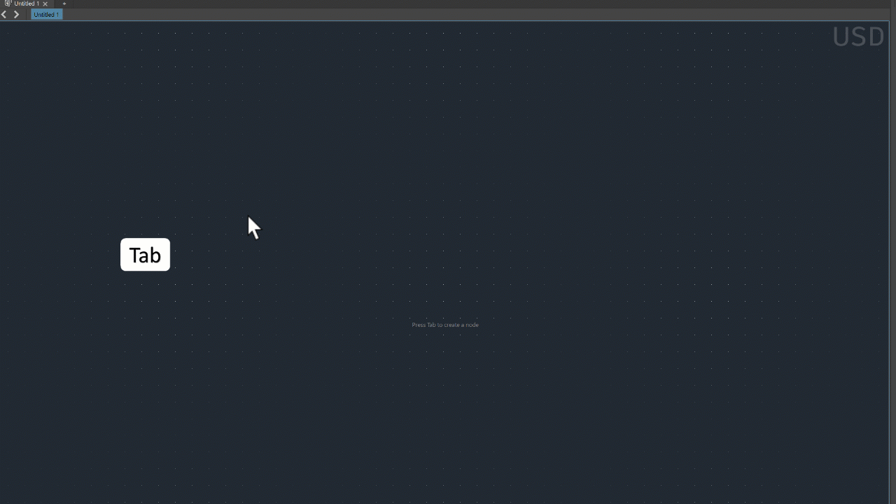

Hit
Tabto create a node in LookdevX. You can either type in the name of the node or search through the categories. In the Tab menu, each node displays the name of the library from which it is sourced.

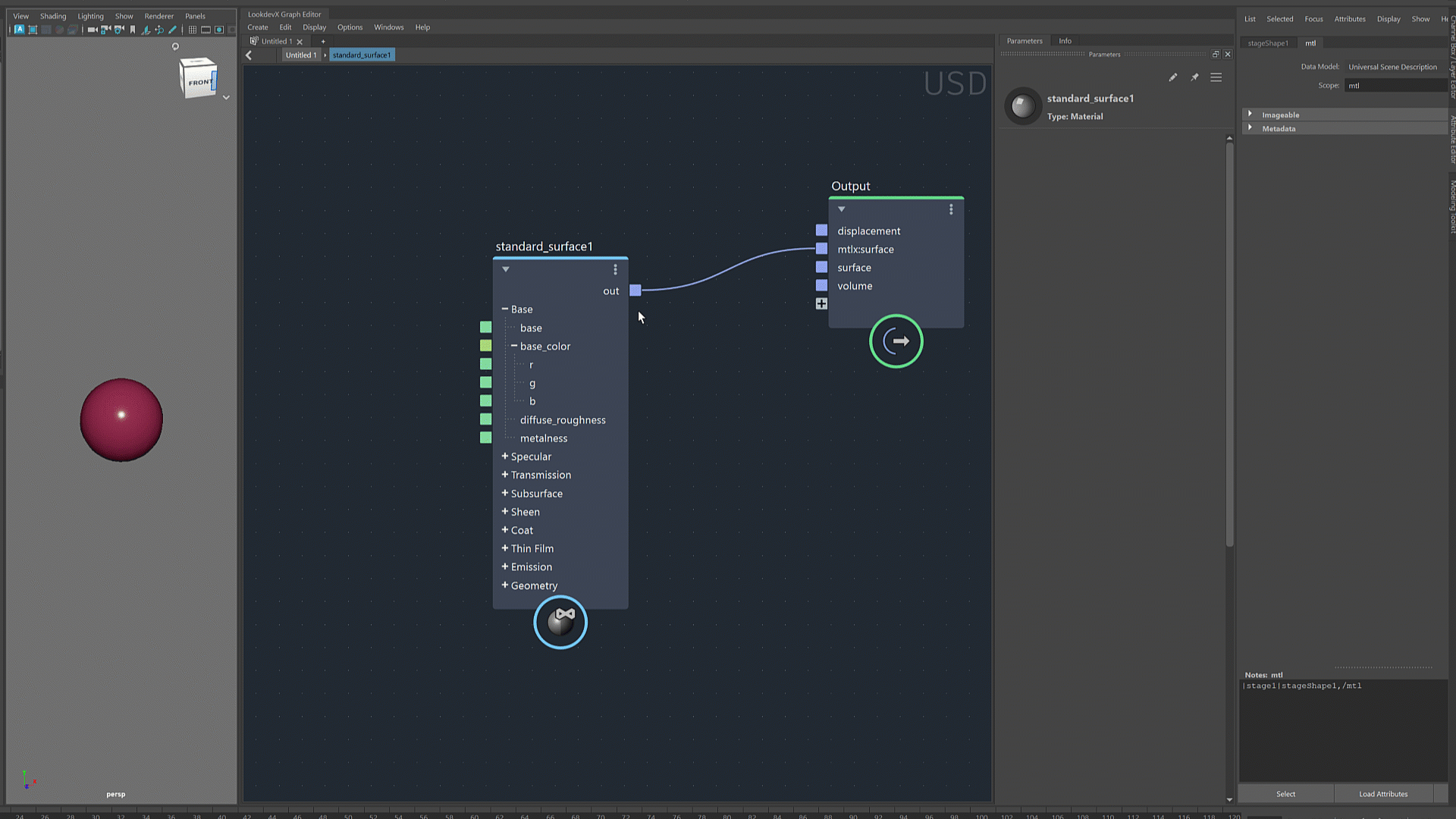

Drag and drop a node from the node library. The node library enables quick browsing and selection from categorized nodes, enhancing your overall efficiency. To show the node library, select Windows and toggle Node Library.

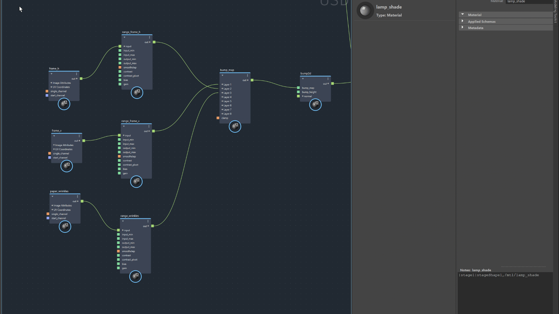

Add Backdrops:
Backdrops are organizational nodes that enhance the readability and usability of graphs. To add a backdrop, simply select the nodes, right-click, and select Create Backdrop.
