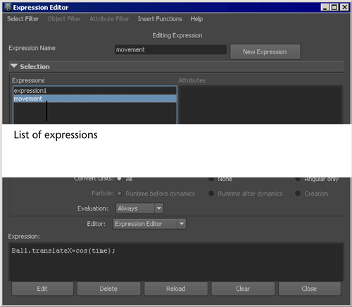

Find an expression by name
To find an expression, you can select from a list of all expressions in the scene.
To search for an expression by name
  1. In the Expression Editor, click Select Filter > By Expression Name.
    An Expressions list appears in the Expression Editor. This list shows all expressions created for the scene.
  2. Click the expression in the list.
    The expression contents appear in the expression text field.
    If you don’t remember the name of the expression, click each name on the list until the desired expression appears in the expression text field.

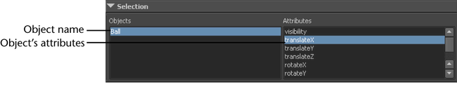

Find an expression by selected object
If you can’t remember the name you gave an expression, you can find it by selecting the affected object. For a non-particle shape node, you can also select an affected attribute from the Attributes list to narrow the search for the expression.
To search for an expression by object and attribute name
  1. Select the object or node in the Outliner, Hypergraph, or workspace.
  2. In the Expression Editor (Windows > Animation Editors > Expression Editor), click Select Filter > By Object/Attribute Name.
    This is the default search setting for the Expression Editor.
  3. Select Object Filter > Selected Objects.
    The selected object’s name and appropriate attributes appear in the window.
  4. For an object other than a particle shape node, click the name of the attribute controlled by the expression.
    If you’ve forgotten the name of the attribute controlled by the expression, select Attribute Filter > Connected to Expressions. The Attributes list displays only the attributes controlled by expressions for the selected object. Click each attribute in the Attributes list until you see the desired expression in the expression text field.
