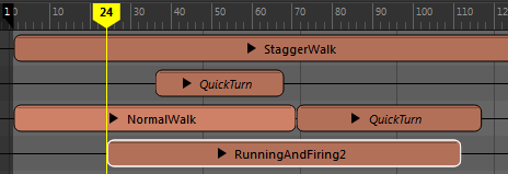

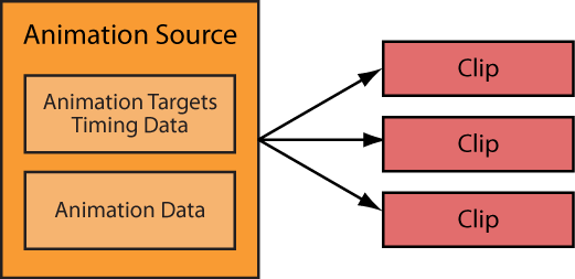

Animation Sources are the various types of data that you can use to drive the motion of an object. The Animation Source is the data that tells a model how to move. Without one, your object is static. Whenever you create an Animation Clip, even a single-frame Pose clip, the Time Editor creates an Animation Source. You can also create Animation Sources from existing animation in your scene (see Add Maya scene animation to the Time Editor). When you drag an Animation Source onto a track, a Clip is created.

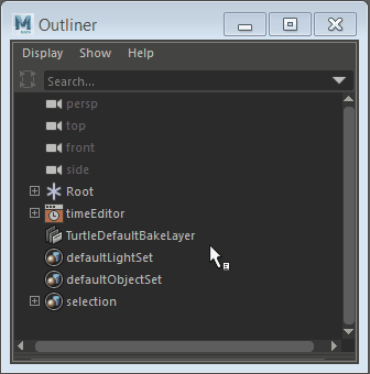

You can find the Animation Sources in your scene in the Time Editor Source menu as well as the Outliner. You can filter the Outliner so that you see only Time Editor nodes by entering timeEditor in the Outliner Search field.

Reusing Animation Sources
- Copy and paste clips
- Split a clip
- Duplicate Compositions
- Drag an Animation Source from the Outliner into the Time Editor (if that Animation Source is already in use by a clip)
