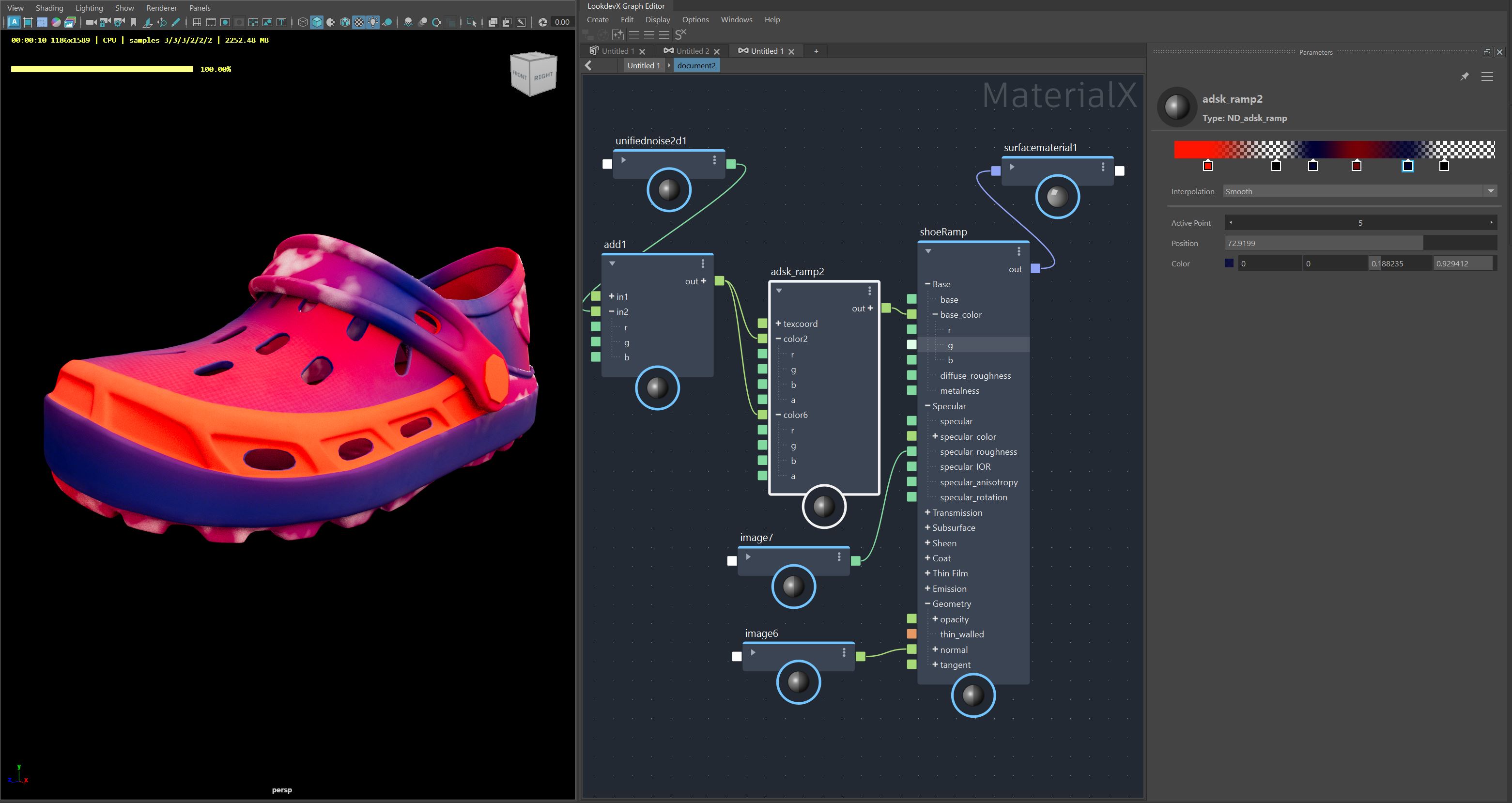

Ramp Node
There is a new node library that enables the creation of a ramp in your LookdevX graph.
