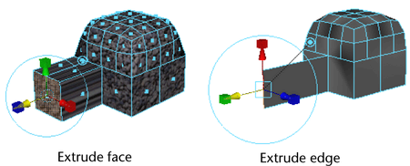

You can add polygons to an existing mesh by extruding polygon faces, edges, or vertices. For example, when you extrude a face on a polygon mesh the existing face telescopes inwards or outwards as it creates new connecting faces on the sides of the extrusion.
Note: The Extrude options window (Edit Mesh > Extrude > ) is context sensitive. That is, when you display the Extrude options window, only the options for the currently selected components (faces, edges, or vertices) are displayed in the window.
