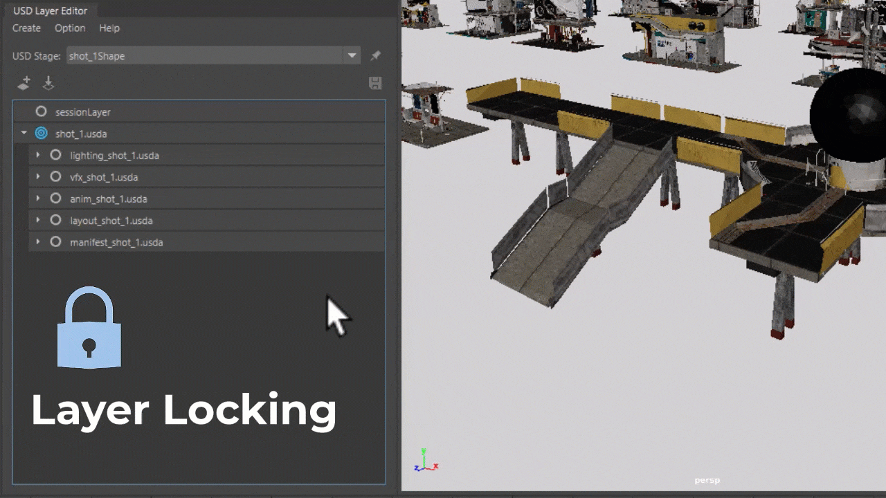

Layer locking
This update introduces layer locking. You can now work confidently without concern of editing in the wrong layers.
  • You can lock or unlock one or more layers with the lock icon in the USD layer editor.
  • This lock state is saved as part of the Maya data, ensuring its persistence even after reopening the project.
  • Administrators can enforce system-level locks on layers, preventing standard users from unlocking them. This can be done via Mel or Python scripts, or by locking the USD file on disk. The system-locked layers are easily identifiable by the disabled lock icons. Note that system locks are not saved as part of the Maya data.
gif for layer locking
