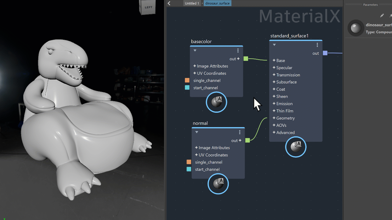

Hide input nodes
In LookdevX 1.4, you can hide input nodes with a simple right-click to keep your graph clean. You can also view connection details by hovering over the extended port.

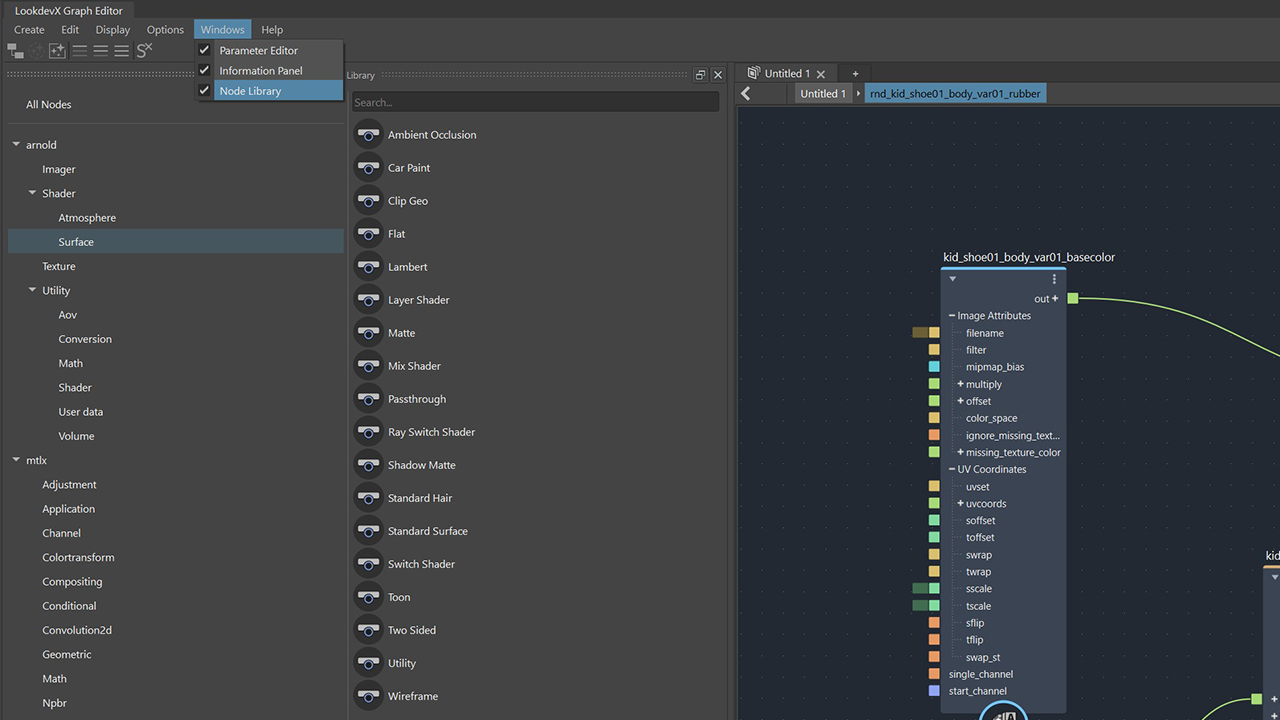

Node library
The new node library enables quick browsing and selection from categorized nodes, enhancing your overall efficiency.

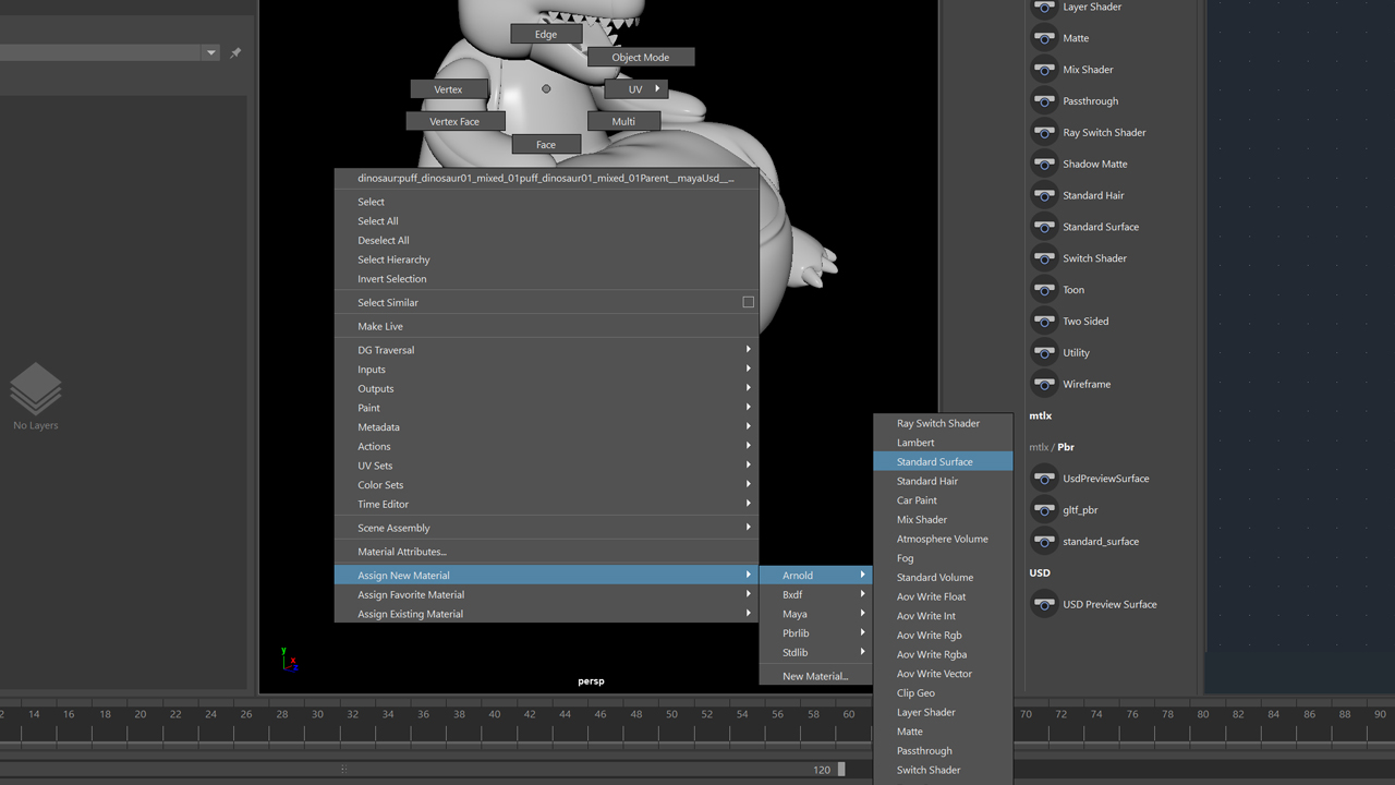

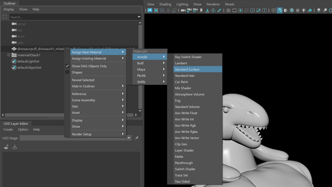

Material assignment menu in the Outliner and Viewport
A new material assignment menu is now available in both the Outliner and Viewport. You can easily select and assign materials to your models.

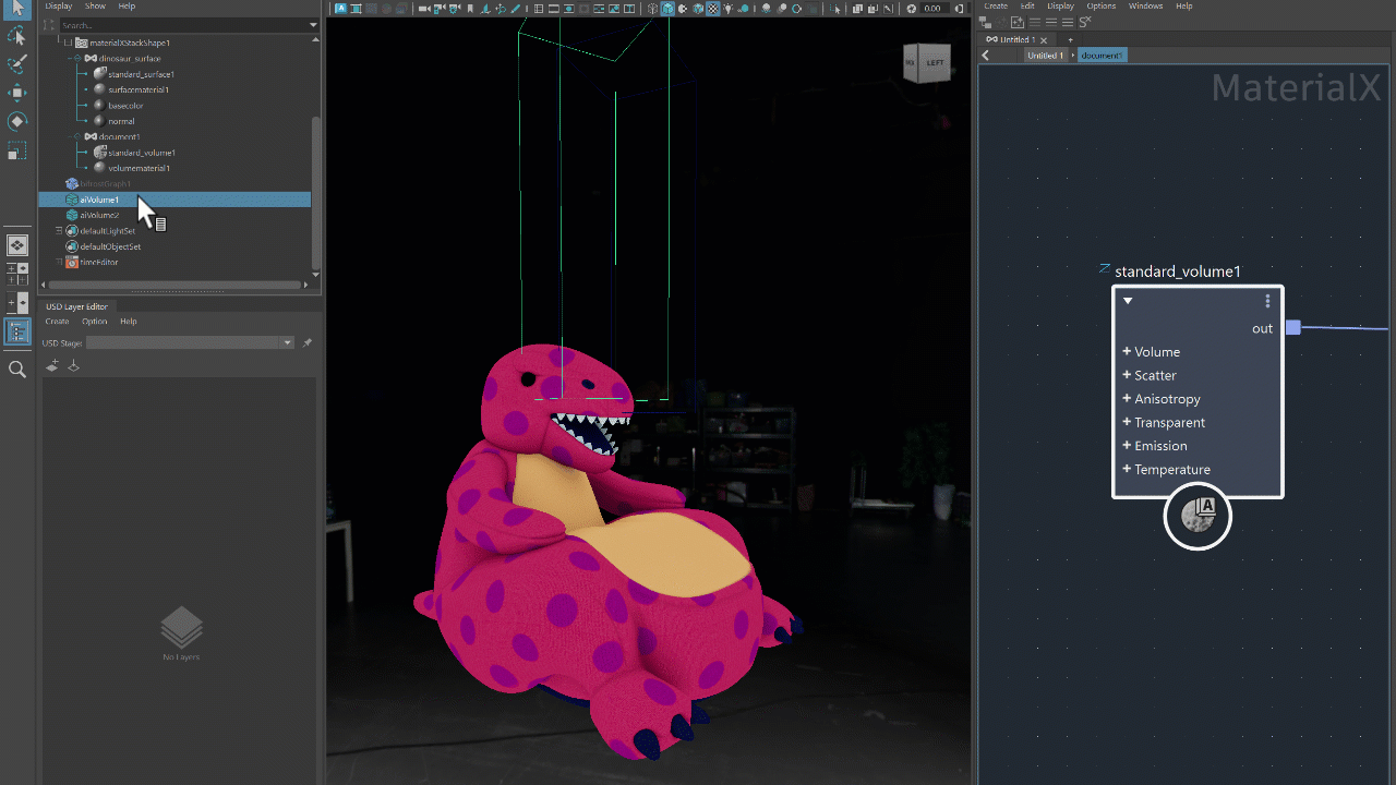

Support volume shaders
In addition to surface and displacement shaders, this update also supports volume shaders in the MaterialX data model.
