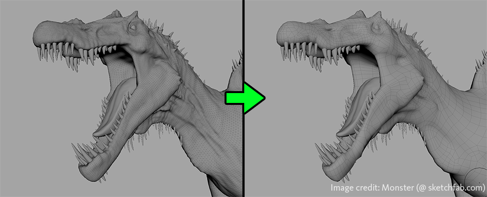

Generates clean, new topology that preserves the surface features of a selected mesh while ensuring all the faces are quads. Use the following options to set what happens when you select

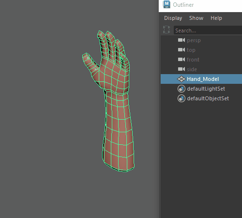

- Keep Original
- Specifies whether to retopologize a copy of the selected object (result mesh), or the object itself (input mesh). If enabled, Retopologize preserves your input mesh by performing the operation on its duplicate.
- Once
Retopologize runs, the result mesh is placed at the same location as the input mesh. The result mesh is given the same name as the input mesh and the input mesh is renamed
<original_name>_original. In the following example, the input mesh is renamed
Hand_Model_Original.
Tip: When both meshes are visible, it's easier to make edits to your input mesh, like defining component tags, and see updates on your result mesh dynamically. - Preprocess Mesh
- Optimizes dense input meshes to speed up and increase the success of the Retopologize operation. This option is specifically designed for input meshes with high triangle counts (100k+) that may contain topological noise and mesh defects. It is not intended for use with low resolution meshes with clean geometry. For more information, see
Best practices for preprocessing a mesh with Retopologize.
Tip: Preprocessing optimizes dense meshes, which entails smoothing and may result in a loss of detail. When Preprocess mesh is turned off, more details are preserved, but the Retopologize operation may take longer to complete.
