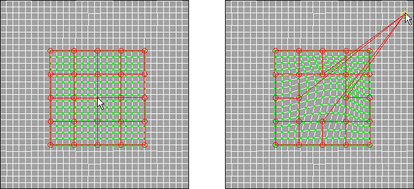

The UV Lattice Tool gives you a high level of control over your UVs by letting you edit the layout of numerous UVs at a time with a 2D lattice deformer.
To edit the layout of your UVs using the lattice manipulator
- In the scene view, select the polygonal or subdivision surface object whose UVs you want to manipulate.
- Select
The UV Editor appears.
- In the
UV Editor’s view, switch to UV mode.
Right-click in the view and select UV from the marking menu that appears.
- Select , or in the UV Toolkit's section, click the Lattice button.
- In the

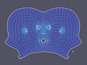

UV Editor, marquee select the UVs you want to manipulate (you can also do this before activating the tool).

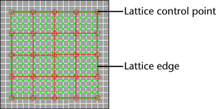

A UV lattice manipulator appears over and surrounding the target UVs.
- Select the lattice edges or control points that affect the region of UVs you want to manipulate by clicking them.
Shift-click lattice edges or control points to include them or remove them from your selection.
- Drag the selected lattice edges or control points to deform the layout of the target UVs.
