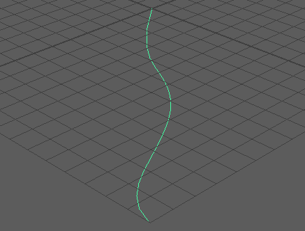

- Create a curve to be your base for the animation. (Select
to draw out a curve.)
- Select your curve and go to
to open the
Offset Curve Options.
- Set Offset Distance to 0.00.
- Set Curve Range to Partial and click Offset. A new curve is created on top of the original.

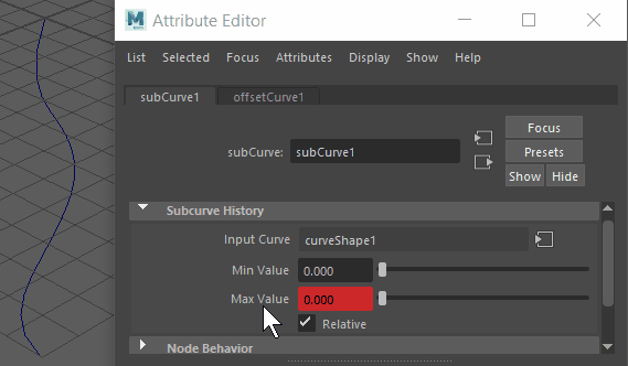

- With the new curve selected, open the Attribute Editor (Ctrl + A)
- Locate the
offsetCurve1 tab, and click
(Upstream Connection).
- With the Time Slider at frame 1, change the Max Value of the Subcurve History to 0.00.
- Right-click the Max Value field and choose Set Key.
- Move the Time Slider to frame
120 and change the
Max Value of the
Subcurve History to
1.00. Right-click
Max Value and set another key. Scrub the Time Slider to ensure the offset curve length changes from 0 to 1.

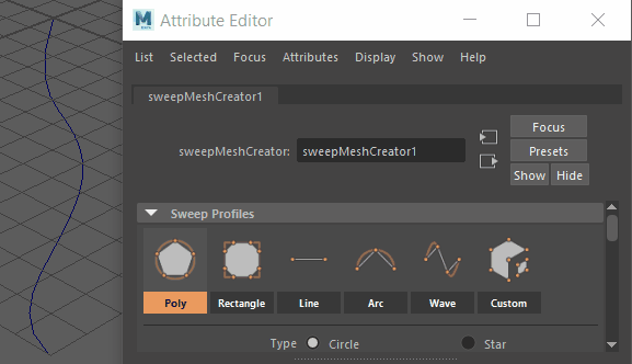

- Select the animated offset curve, and select
Sweep Mesh
from the Poly Modeling shelf or
in the
main Maya Menu.

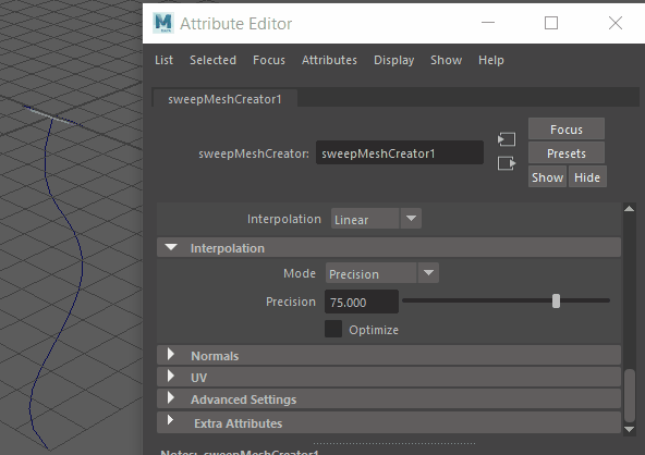

- Play back the animation. The mesh grows like a tube but the curve has angles.
- In the Sweep Mesh Interpolation section, set the Mode to Precision, the Precision value to 1.00, and click Optimize. The mesh curve smooths out.
