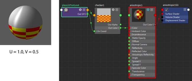

Defines a texture frame—a rectangular area on a surface (in the UV coordinate space) in which the texture appears. You can control the position, size, and rotation of this frame on the surface using the Coverage, Translate Frame, and Rotate Frame attributes. You can also control how the texture is tiled within the frame using the attributes described below.
The two columns of boxes in the Attribute Editor represent U and V values.

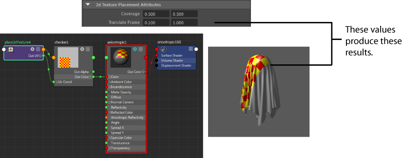

- Coverage
Specifies what ratio of the surface the texture map covers. The valid range is 0 to + infinity for NURBS surfaces. A value of 1 (the default) covers the entire surface in either the U or V direction.
For example, to cover half the surface, set the value at 0.5 in either the U and V directions.
- Translate Frame
The Translate attributes position the texture map on the surface and move the coverage area across the surface. The range is from - infinity to + infinity.

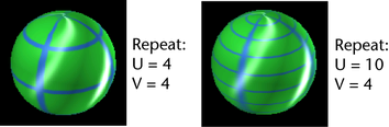

- Repeat UV
Specifies how many copies of the texture map are mapped within the coverage area along either the U or V directions (depending on the texture). By default, Maya maps one copy of the texture. Values greater than 1 result in more copies of the map displayed in the same coverage area. Values less than 1 result in only a portion of the map displayed.
