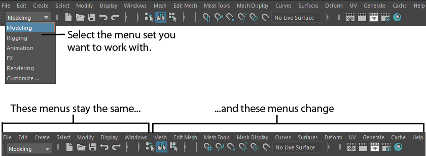

The Modeling menu set is a set of Modeling-specific menus added after the Maya default menus (File, Edit, Create, Select, Modify, Display, and Windows).
Access the menu set from the drop-down menu, or press F2 to switch to the Modeling menu set.
