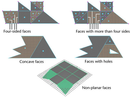

Fix by Tessellation
It’s possible to modify polygon meshes using some of the polygonal editing operations and produce polygonal faces with attributes that you do not want. For example, four-sided faces, faces with more than four sides, concave faces, faces with holes, and non-planar faces. These options let you clean up these problems by tessellating (triangulating) the offending faces.
The following illustrations show the kinds of problems you can encounter with polygonal faces.

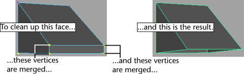

Faces with zero geometry area
When you select to remove faces with a zero geometry area (for example, remove faces with areas between 0 and 0.0001), faces are removed by merging vertices. To ensure that this operation removes faces with areas within the defined tolerance, you must set the length tolerance for the edge vertices to be merged. If you do not otherwise want to remove edges within the length tolerance, you can turn off the Edges with zero length option after setting the tolerance.
- Area tolerance
Specifies the minimum area of faces to be removed when the Faces with zero geometry area is on.
