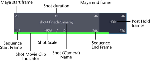

Camera shots in the Camera Sequencer represent the time(s) at which a particular camera is active. They are the tool that lets you manipulate and change the timing of each shot.
Shots are represented as a set of rectangles arranged on tracks in the Sequence Editor. You define the sequence of active cameras by moving and scaling shots relative to one other. By moving, scaling, trimming shots, you can manage the ‘filming’ of your scene. See Manipulate camera shots in a sequence.
Camera shot overview
For more information on each attribute that displays on the camera shot, see Camera shot attributes.
