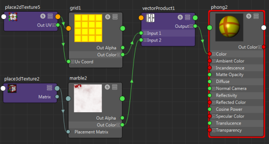

Multiplies a vector by another vector or by a matrix. The Vector Product node has three parts—two input attributes, an operator that you apply to the two input attributes, and an output attribute that holds the result.

- Operation
Displays a drop-down list from which you can select an operator. The following examples are based on Input 1 as a Grid texture and Input 2 as a Marble texture. The Operation is set to Vector Matrix Product.

- Vector Matrix Product
Produces a vector by multiplying the Input1 attribute and the Matrix attribute, as in the following formula:
Outvector = Input x Matrix
- Point Matrix Product
Produces a point by multiplying the Input1 attribute and the Matrix attribute as in the following formula:
Output = Input x Matrix
