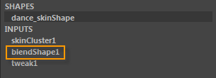

- Automatic (formerly called Default)
The default recommended setting. Maya determines where the blendShape node should be located in the object's history based on the deformers that are currently connected on the selected object. The blendShape node will be placed using either the Pre-deformation or Post-deformation options:
- The blendShape node uses the Pre-deformation option if the selected object has no deformers, or it has a Skin, Cluster, or Blend Shape deformer in its history. These types of deformers are supported by the Shape Inverter.
- The blendShape node uses the Post-deformation option if the object has any nonlinear deformers (Bend, Flare, Sine, Squash, Twist, Wave) or any of the following deformers in its history: Delta Mush, Jiggle, Lattice, Morph, Muscle, Point on Curve, Sculpt, ShrinkWrap, Soft Modification, Solidify, Tension, Texture, Wire, Wrap, and Wrinkle. These types of deformers are not supported by the Shape Inverter.

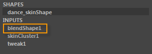

- Pre-deformation (formerly called Front of chain)
Maya positions the BlendShape node so that it's evaluated before all the deformers (including Skin nodes) in the selected object’s shape history, but after any of the Tweak nodes. Tweak nodes keep track of the translation of the points on the base object as it's deformed - see Point tweaking on objects.
Blend shape deformers are often used to create deformation effects on a skinned character, so Pre-deformation assures that the effects from blend shape deformation occur before those caused by the skin. For more information on doing this, see Create pre-skinning corrective shapes.

- Post-deformation (formerly called Before)
Maya positions the blendShape node so that it's evaluated after all the other deformers on the selected object. In the object’s history, the BlendShape node will be placed above all other deformers, directly below the object's Shape node.
Post-deformation shapes are mainly used for sculpting corrective shapes on skinned characters - see Create post-skinning corrective shapes for information. These target shapes must be either Tangent Space or Transform Space type (see Add Blend Shape Target Options).
The Post-deformation order ensures that the corrective shape is evaluated after the effect of the skin deformation has been calculated, so the deltas are smaller and the deformation is generally smoother than with Pre-deformation shapes.
