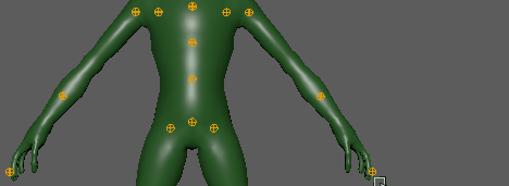

- Guides are helper markers that you use to adjust joint placements inside the mesh(es).

- Guide Settings
- This area lets you configure the generation of guides that help
Maya align the skeleton joints with the appropriate positions on your mesh.

- User Adjustment of Guides area
- You can manually position the guide helpers that Maya uses to create the skeleton to achieve a better match with your character mesh using the Move tool. Use the options below to help with positioning.
