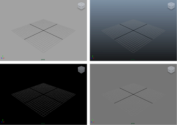

Change the view panel background color
You can quickly toggle among different background colors in the view panel by pressing Alt+B.
You can also set the preferences to change the default background.

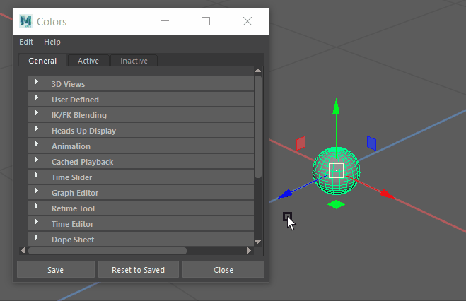

Set a custom background color
  1. Select Windows > Settings/Preferences > Color Settings.
  2. In the Colors window that appears, select the General tab and expand the 3D Views section.
  3. Do one of the following:
    • To change the default background color, click the Background color swatch or adjust the slider.
    • To change the gradient background colors, click the Gradient Top and Gradient Bottom color swatches or adjust the sliders.
