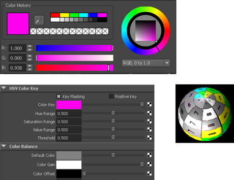

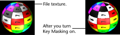

To use the Key Masking attribute
  1. Turn Key Masking on. Since the Color Key attribute’s default color is black as well as the Stencil’s Default Color, Maya masks out only the areas containing the most black.
  2. Change the Color Key color in the Color Chooser. In the following, Maya masks out any color containing red or pink and replaces it with the Stencil’s Color BalanceDefault Color.
