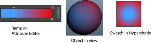

Type
The direction of the color ramp. The default is V Ramp. The following shows what happens when you select the Circular Type and adjust the colors of the Ramp swatch in the Attribute Editor (see also Ramp below).
Interpolation
See Interpolation for more information.
Ramp
By default, the Ramp is set to black and white (from black to white).
You can switch over to a rainbow ramp by selecting Presets > Rainbow. To revert back to the default, select Presets > BlackToWhite. Another available option is Presets > WhiteToBlack.
See Color ramp for more information on how to customize your ramp by adding additional color entries.
Note: Only changes in Interpolation, Selected Position, and Selected Color are displayed in the ramp. Changes to all attributes are displayed in the Hypershade swatch.
