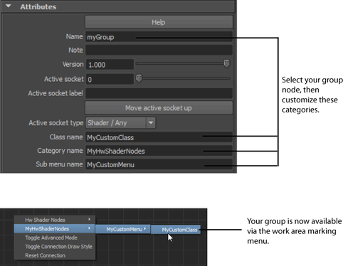

  1. Select the group node and click its Group icon to visualize the group network.
  2. In the group network view, select the group node. In the Maya ShaderfxShader Attribute Editor, you can customize the following:
    • Name
    • Category
    • Sub menu name
    • Class name
  3. Click Group > Save Group to Disk in the ShaderFX editor.
    Your group node, now renamed to Name, is accessible when you right-click the work area, and appears in the marking menu as Category name > Sub menu name > Class name.
