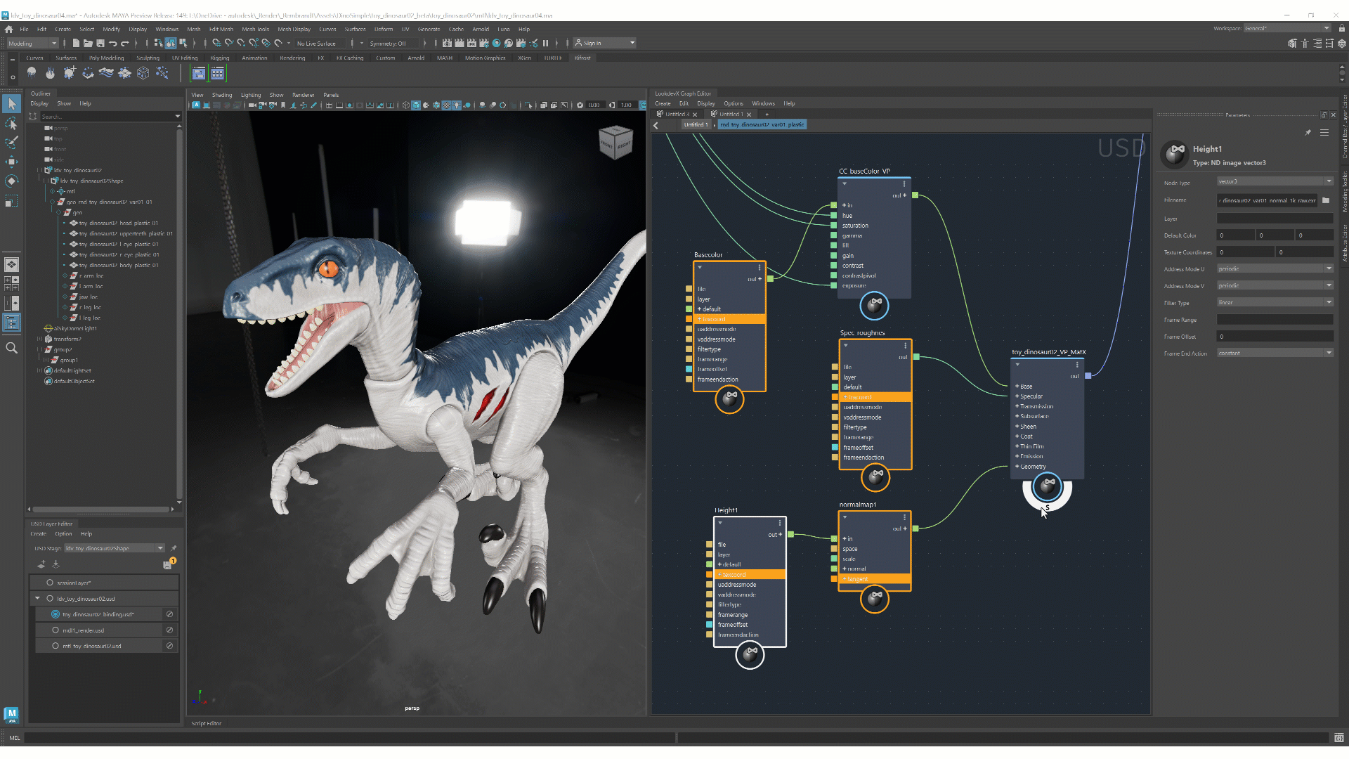

LookdevX for Maya v1.2.0 Release Notes
LookdevX 1.2.0 introduces a variety of new features and a range of UX improvements.
Release Highlights

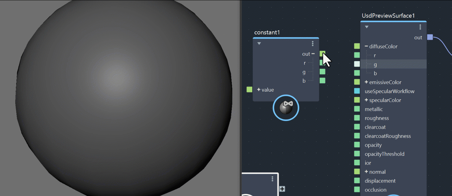

Solo Nodes:
Soloing enables faster lookdev workflows and efficient graph troubleshooting. By soloing a node in the graph, you can inspect the render of its upstream nodes. This feature supports both Arnold and MaterialX graphs, including materials, shaders, and compounds.

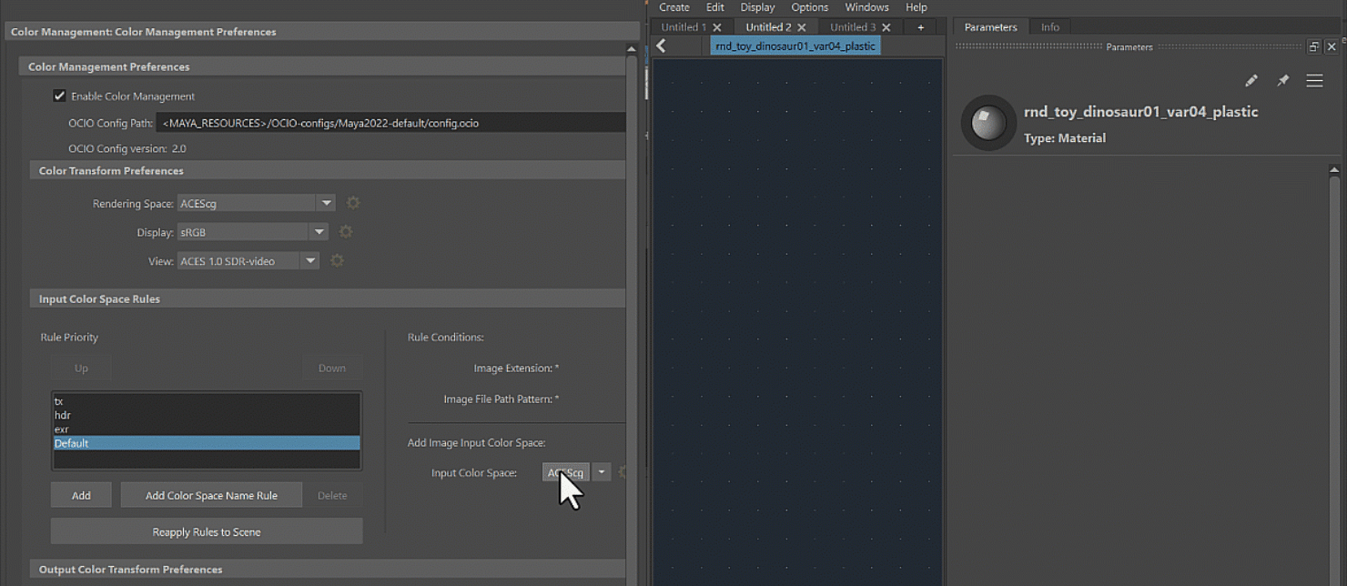

LookdevX Graph Controlled by DCC's Color Management Preferences:
You can now trust the color accuracy as all color management operations are controlled by DCC color manager. This includes: input color spaces for textures, color pots, color picker and color swatches. Furthermore, Color Management data is precisely embedded in USD files and can be read from them accurately.

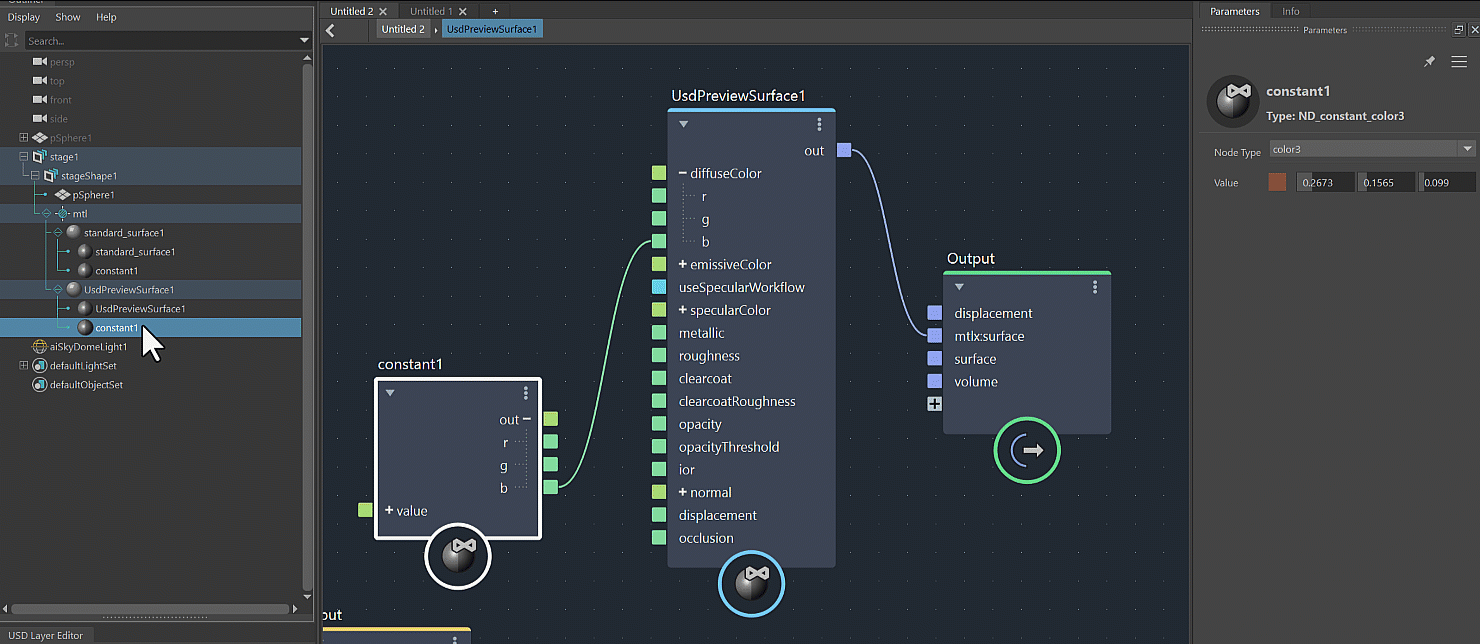

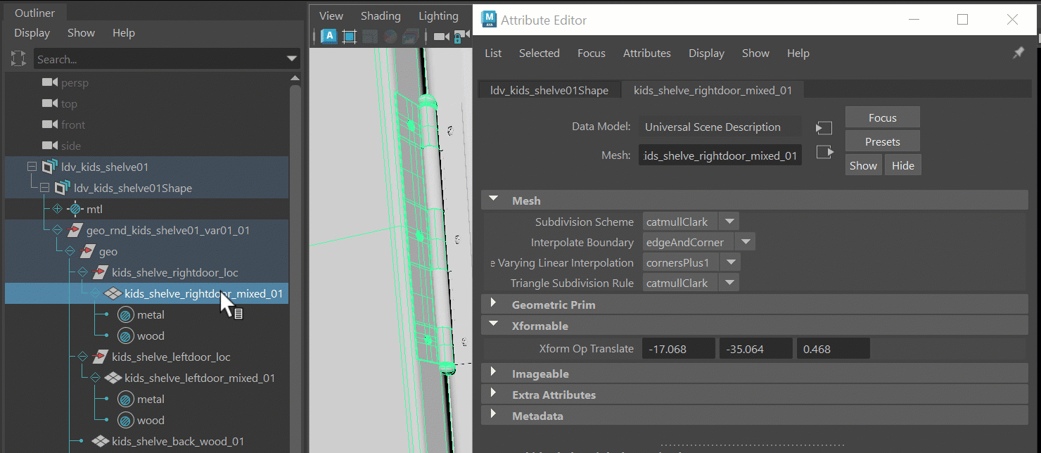

Copy, Paste & Duplicate Nodes and Materials:
You can now perform copy, paste, and duplicate operations using the Outliner and LookdevX toolsets. Moreover, you can duplicate with or without the connections.

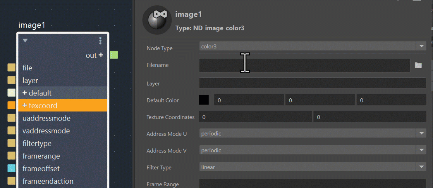

Dynamic Port Workflow:
You can now enjoy a streamlined shader creation workflow. Instead of multiple separate shaders, there is now one unified shader. Within the parameters panel, you can select their desired shader type. If there are any issues with the type selection, intuitive error messages help you find the right shader type by highlighting the problematic node and providing a detailed explanation in the info panel.

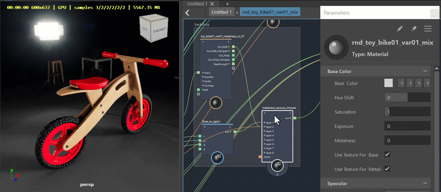

Shader Component Workflow Support:
You can delve into more advanced graphing using the integrated component workflow.
Component Tags – Direct material assignment:
You can now assign materials to native USD Geometry subsets with confidence. When a USD geometry is converted to a Maya geometry and vice versa, any material changes made on either data model will be accurately preserved.

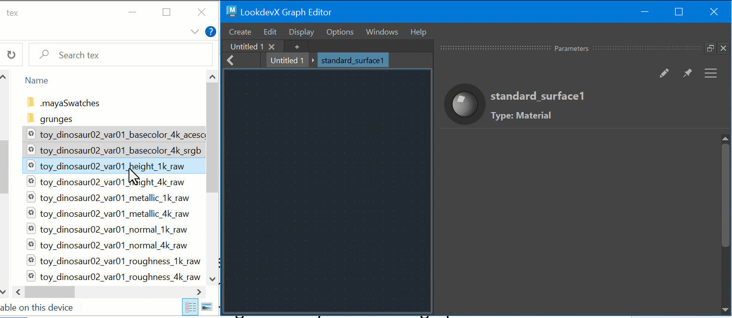

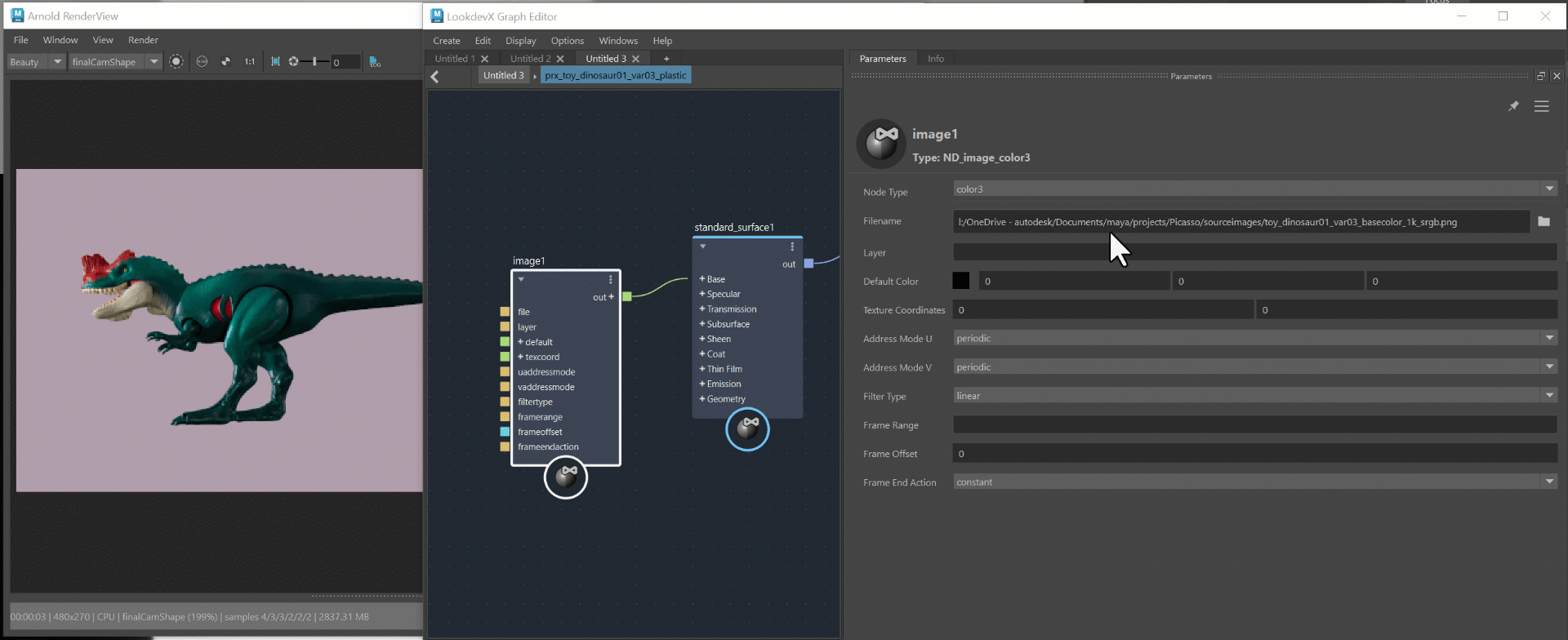

Drag and Drop:
You can now drag and drop files from an external file browser.
