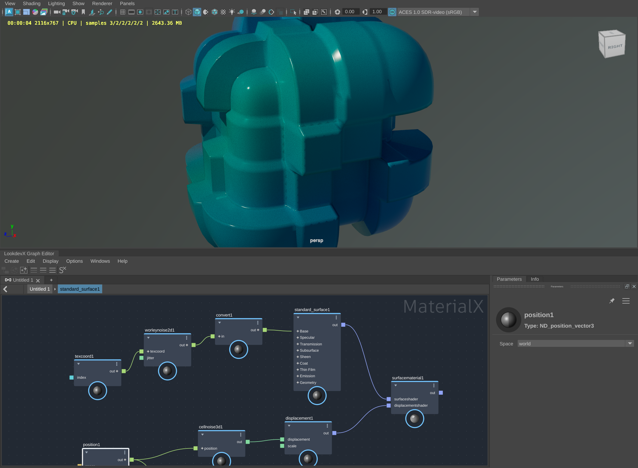

- Support for MaterialX shader networks in LookDevX: MtoA 5.4.0 adds support for the new LookDevX MaterialX node graph editor. This allows you to assign LookdevX shader networks to Maya geometry and mix MaterialX shader nodes with Arnold shaders. (MTOA-1672, MTOA-1703)
| LookDevX MaterialX graph with Displacements |

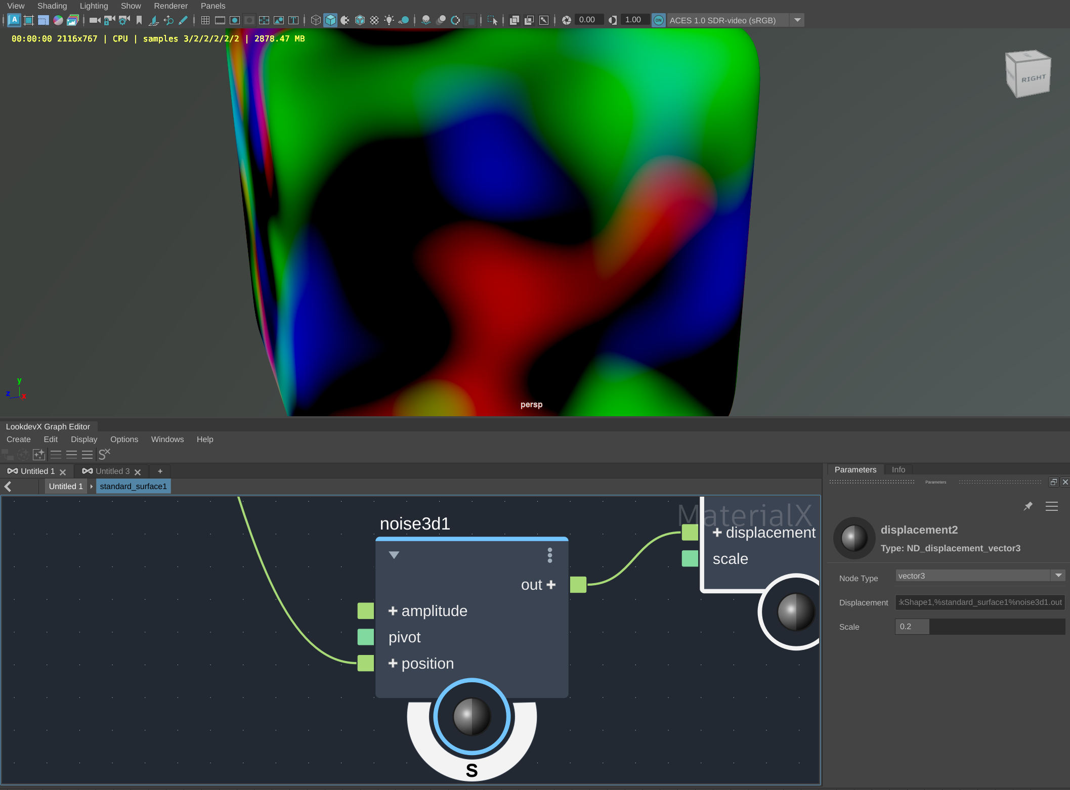

Soloing individual nodes in the graph
| Soloing an individual shader in a LookDevX node graph |

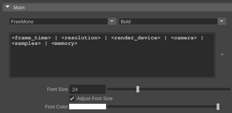

- Better editor for the overlay imager: The editor for the overlay imager is now more intuitive and previews the choosen font and style (MTOA-1664)

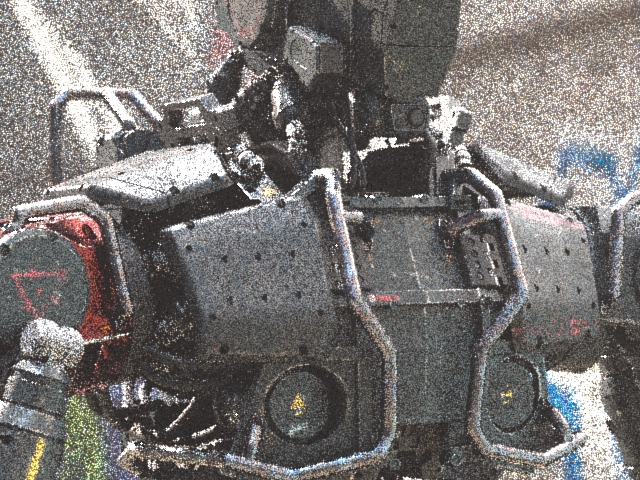

- Progressive dithered sampling: Arnold now supports dithered samples in progressive and adaptive rendering. Dithering brings nicer noise distributions at low AA sample counts. (ARNOLD-10739)
| before 7.3.0.0, AA=1 | 7.3.0.0, AA=1 |
