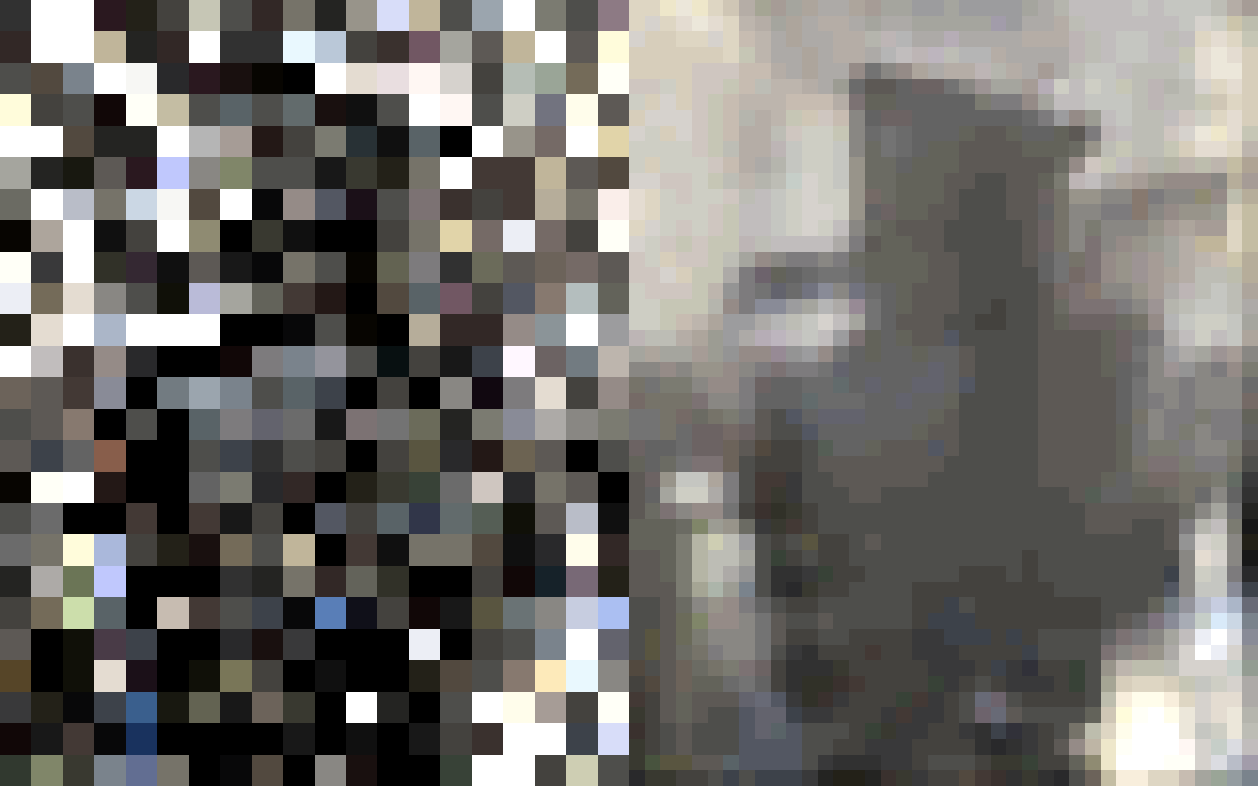

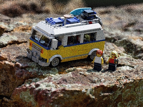

- Denoising by default with Intel Open Image Denoise (OIDN): The Intel ® Open Image Denoiser imager is now added by default to new scenes (MTOA-1787)
| without denoising | with imager_denoiser_oidn |

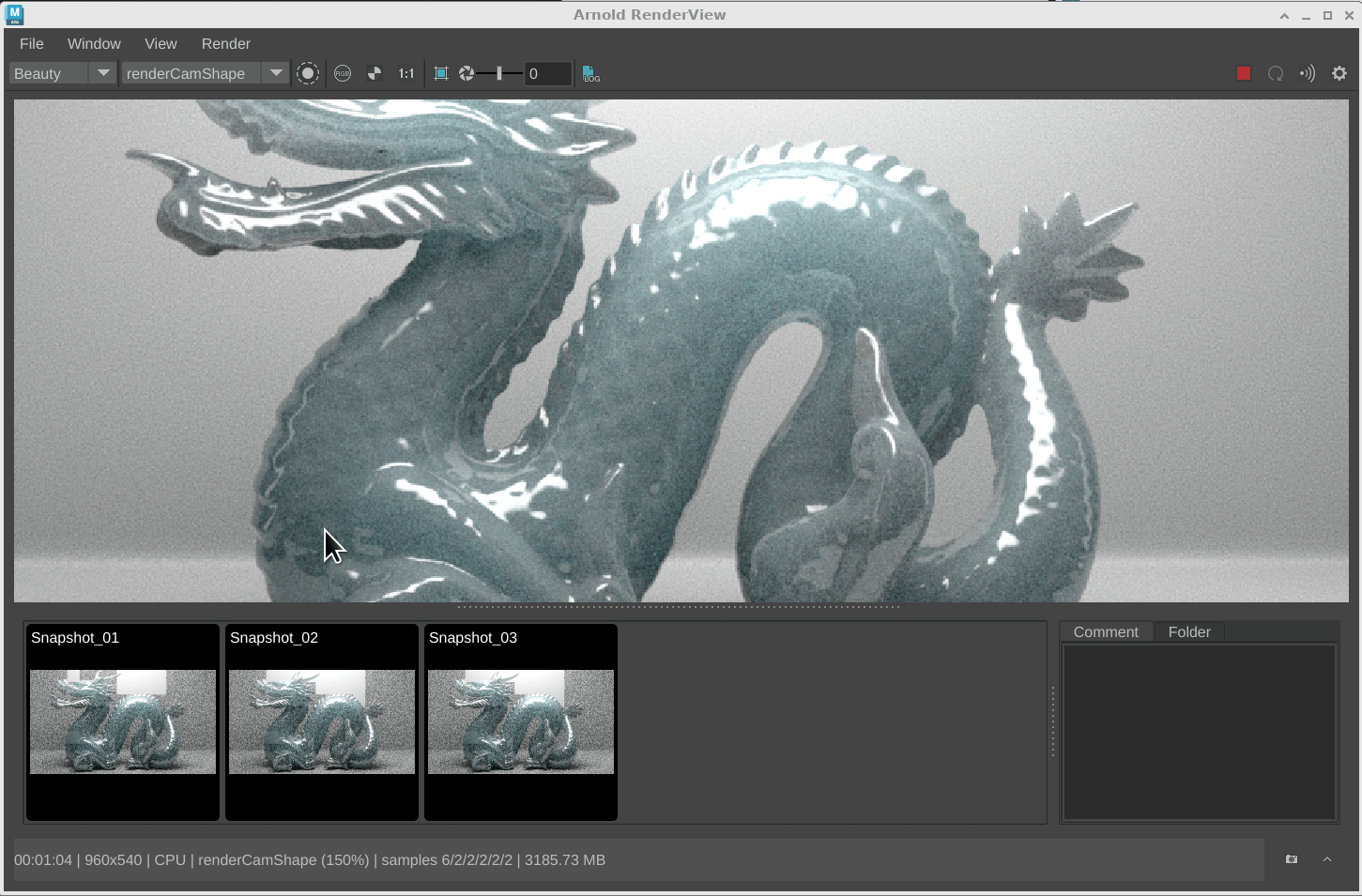

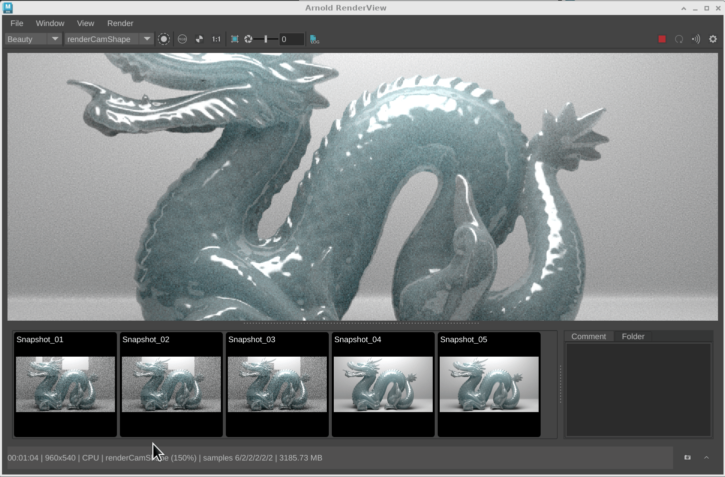

Improvements to the Arnold Render View Snapshots: The snapshot workflow and interface in the Arnold RenderView has multiple enhancements and behaviours.
- Press the S hotkey in the Arnold RenderView to save a snapshot.
- Improved UI for Snapshot buttons (ARNOLD-232)
| You can now compare snapshots of the same resolution using the Ctrl key modifier when selecting a second snapshot |
| You can now select multiple snapshots with the Shift modifer and delete multiple selected snapshots with the Del key |

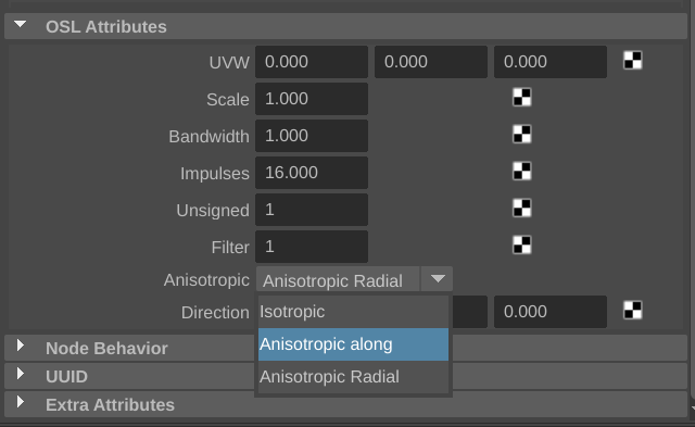

- OSL Enum support in Attribute Editor : Shader parameters of type ENUM on the OSL code node create a combo box with the available options (MTOA-1781)
| OSL enum parameter values displayed as a drop-down list |
