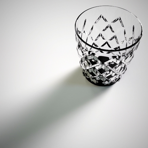

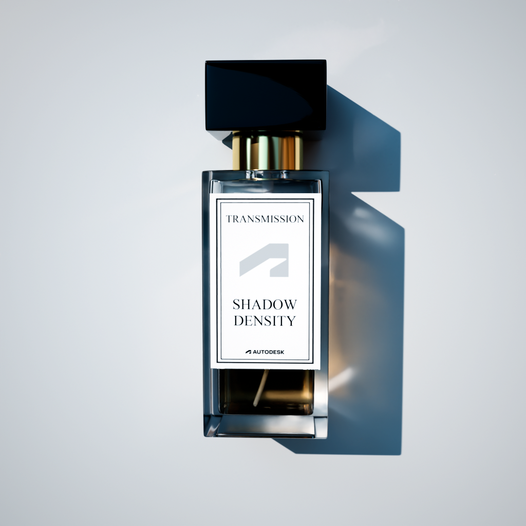

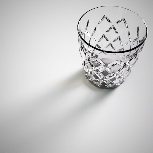

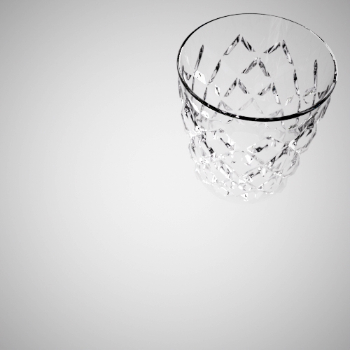

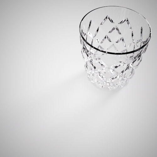

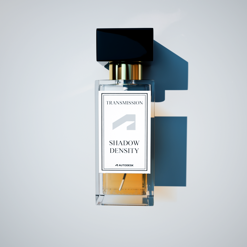

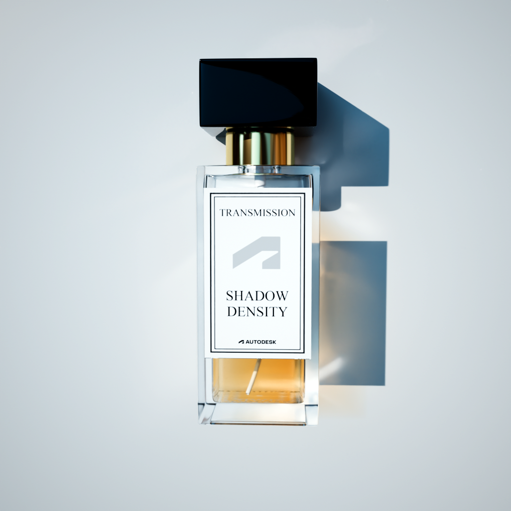

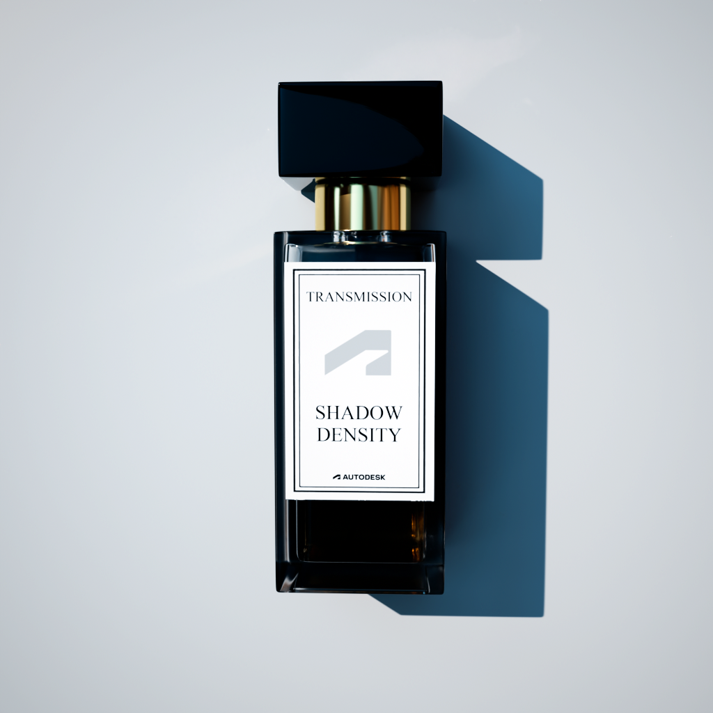

  • Improved, more realistic shadows for glass objects: Transparent objects like clear glass now cast shadows. The look of the shadow is controlled by the new transmission_shadow_density parameter on the openpbr_surface and the standard_surface shaders. (ARNOLD-6881, ARNOLD-15863, ARNOLD-15828)
0 0.5 0.9 1
transmission shadow density = 0 transmission shadow density = 1
caustics off
caustics on

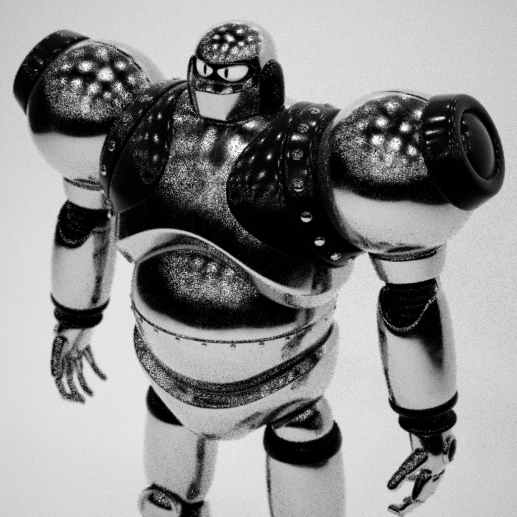

  • Improved Global Light Sampling (GLS) on glossy materials: GLS now takes material glossiness into account when sampling, which greatly enhances the quality especially when many small lights are present. It causes small slowdowns for fixed AA renders, but for adaptive renders, it brings overall speedups. For example, with adaptive in the robot scene below we achieved 1.7x speedup. This feature can be enabled and disabled using GLS_glossy_enable. (ARNOLD-15489)
7.3.5, fixed AA 7.3.7, fixed AA
Camera(AA): 2, Specular: 1.
