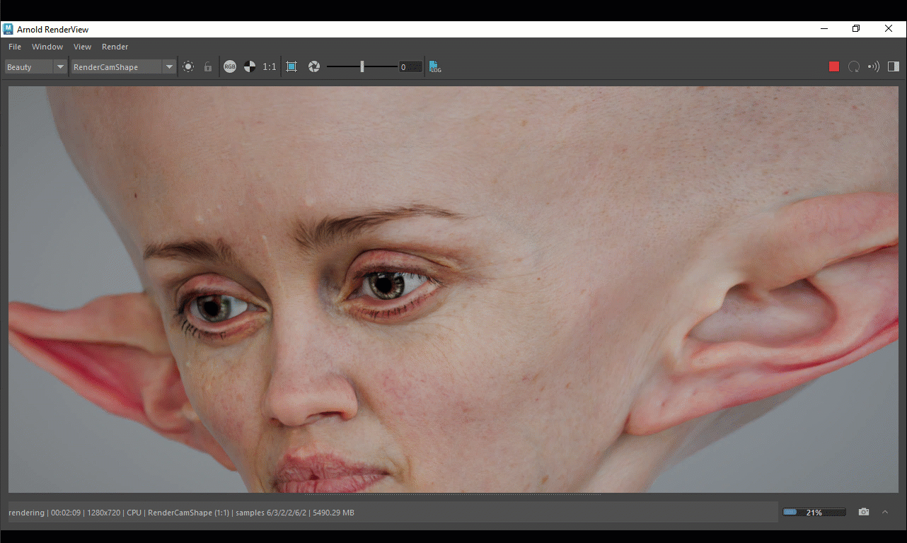

The Arnold RenderView window is an interactive rendering (IPR) utility designed to give real-time feedback on any changes made to the scene while solving several limitations of the DCC's native render view. A long list of artist-friendly features has been added to help with the shading, lighting, and look-dev process, improving interactivity and reducing translation/scene refresh time. For example:
- Smooth, low-latency render updates take place while dragging the mouse rather than at mouse-release time.
- Different cameras, AOVs, and shading modes can be selected at any time, without re-exporting the scene.
- Picking an object with the mouse selects the object in the viewport and highlights it in the RenderView.
- Isolate objects, lights, materials, and even individual shader nodes for easier debugging of shading trees.
- Basic color correction.
- Status bar with comprehensive information about the render in progress and pixel under the cursor.
- Native 3D camera manipulation, including Frame object selection and Frame all.
- Keyboard shortcuts for common actions and display modes.
- Stored image snapshots for easy comparison.

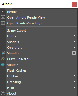

The Arnold RenderView window can be found on the Arnold shelf and under the Maya Arnold menu.

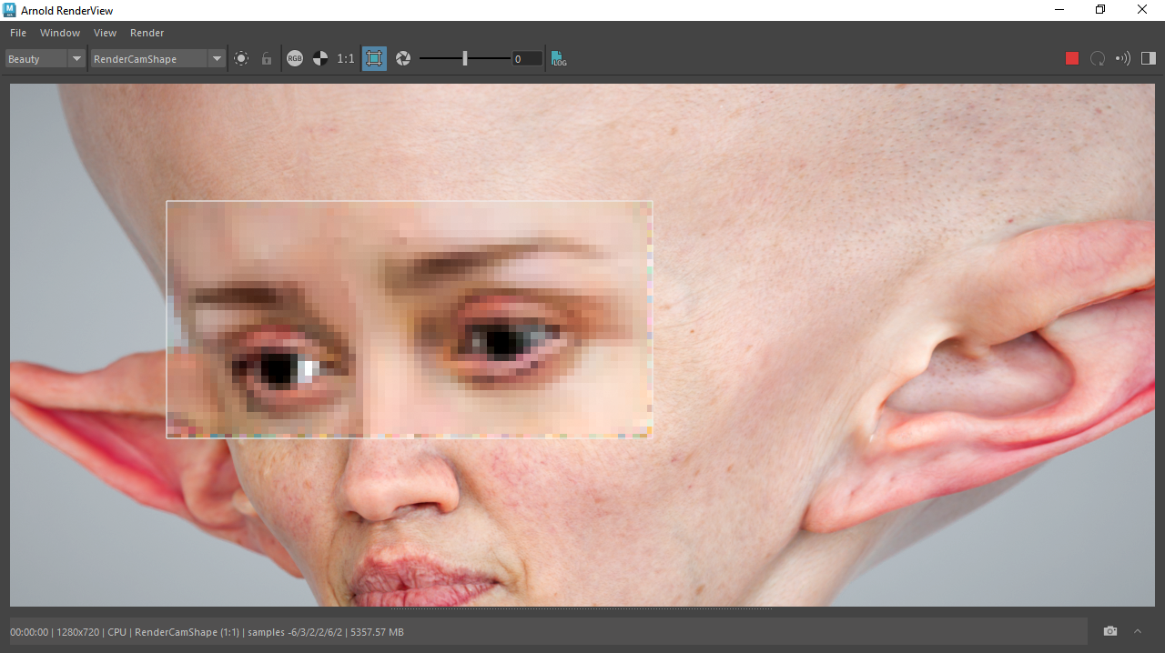

Region Rendering
You can use the Crop Region tool to render it to a specific region only. This can be enabled via the menu Render > Crop Region, by pressing the icon,
or by keeping the SHIFT key pressed while dragging a region.
Once the region has been selected, the "crop" option is disabled, so that mouse clicks over the image are seen as "picking" (see the section below).
To clear the Crop Region and render the whole image, click anywhere on the window while the Crop Region option is active. You can also click on the small cross beside the cropped region to clear the region.

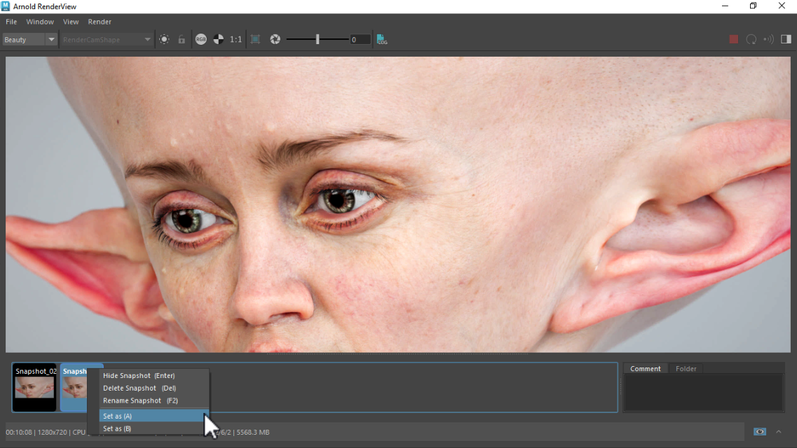

Store Snapshot
Stores the displayed image in memory. When one or more snapshots have been stored, a slider will appear in the toolbar to help navigate between snapshots.
Previous Snapshot
Navigates between previously-stored snapshots. 'Previous' refers to an older snapshot.
Next Snapshot
Navigates between previously-stored snapshots. 'Next' refers to a more recent snapshot.
Delete Snapshot (Del)
Deletes the current snapshot.

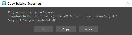

Snapshot library, with thumbnails for each of the stored snapshots. You can also add names and comments.
Snapshots Folder
The snapshot folder where the snapshots are saved to disk. The default snapshots folder inserts a subfolder with the scene name. Changing projects will give the option to copy or move the snapshots (when 'Use Snapshots Folder' is enabled).
Press the S hot key in the Arnold RenderView to save a snapshot. Press the Left and Right Arrow keys to navigate between snapshots, and the Up and Down Arrow keys to toggle between the display of snapshots and live rendering.

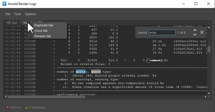

Log
Opens the Arnold Render Logs window where you can view a simple-to-read version of the Arnold log.
IPR Log Frequency
Allows you to control the verbosity of the log during IPR sessions. Last Progressive Step restores the scene verbosity just for the final step by default.
Information on how to read log files can be found here.

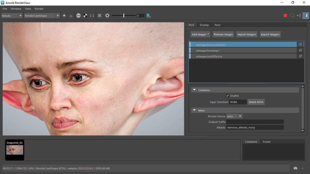

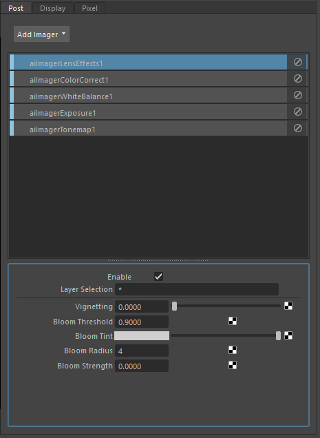

Post
Post-processing nodes called imagers operate on pixels before the output driver. Imagers can be chained together.

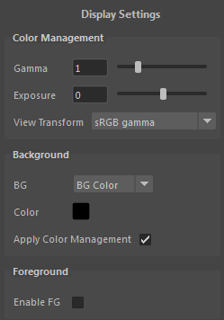

Display Settings
Opens the color correction panel on the right side of the RenderView window, offering various options for adjusting the displayed pixel colors.
Gamma: adjusts the displayed colors with a simple gamma curve.
Exposure: expose the displayed image up or down, in f-stops.
View Transform: choose the default color transform to apply for viewing images in the RenderView.
The overexposed areas near the windows of the interior scenes below particularly benefit from tone mapping.
| Un-tone-mapped (sRGB) View Transform | Unity Neutral Tone Map View Transform |
The RenderView updates the View Transform according to Maya's Color Management settings (including Syncolor native view transforms which are used by default). It is however still possible to override the view transform in ARV only, as with other Maya viewers.
It is recommended that you use the ACES Color Management.
Background
It is sometimes useful to change the color of background pixels in the displayed render.
BG Color: applies a flat background color.
BG Image: displays a background image or texture.
BG Checker: displays a checkerboard pattern as the background.
Apply Color Management: applies Color Management settings to the Background.
Foreground
Applies a foreground image in the RenderView window.
Enable FG: Enable/ disable the visibility of the foreground image.
Image: file path for the foreground image.
Scale: scales the foreground image.
Offset: adds a 2D position offset to the foreground image.
Apply Color Management: applies Color Management settings to the Foreground.

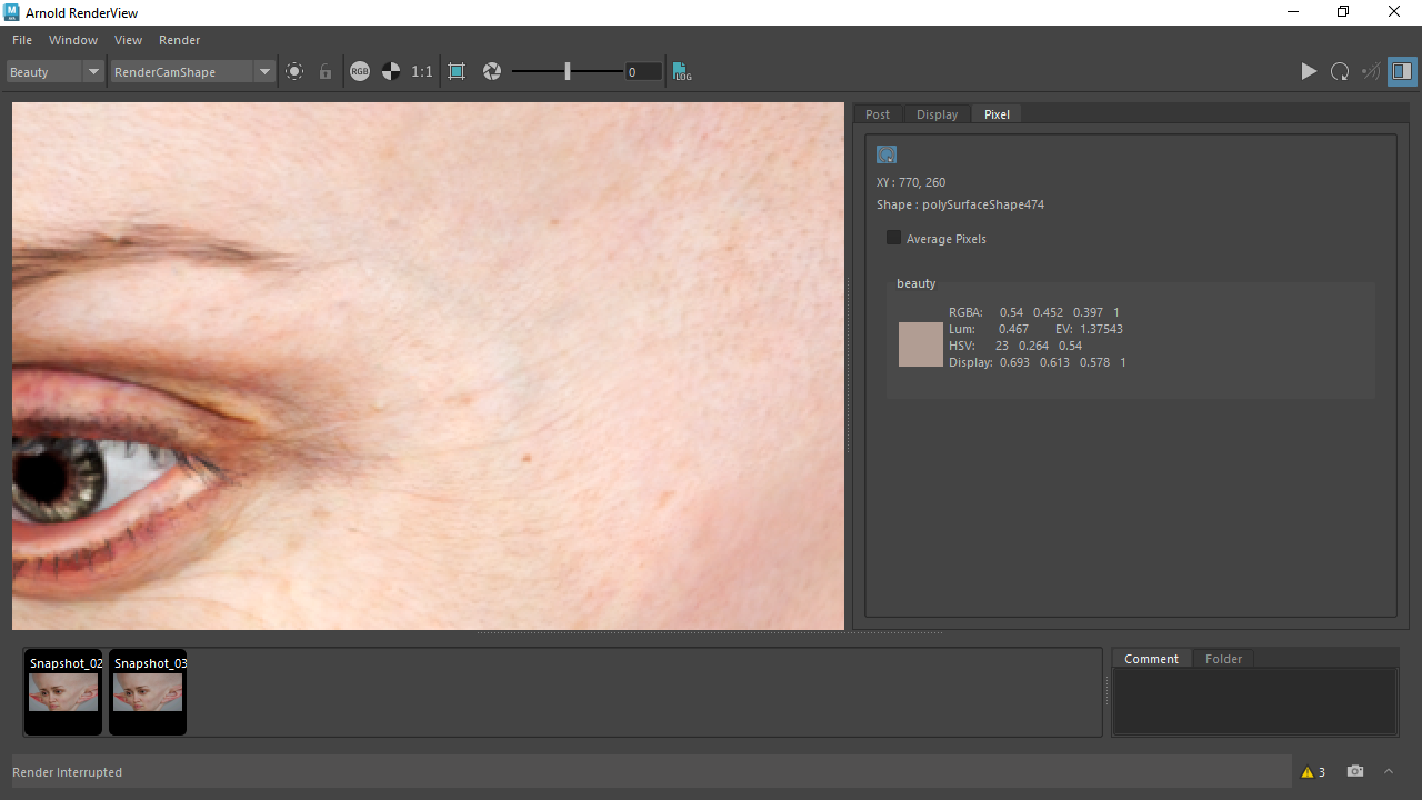

Pixel Information
Shows detailed values for the pixel below the mouse cursor, on all AOVs.
- Pixel XY: coordinates corresponding to the mouse position within the rendered image.
- Shape: The name of the shape below the mouse cursor.
- Average Pixels: T he pixel value that becomes averaged around the surrounding pixels.
- RGBA values as returned by Arnold, below the mouse cursor.
- Luminance values as returned by Arnold, below the mouse cursor.
- HSV values as returned by Arnold, below the mouse cursor.
- Display: Color corrected values below the mouse cursor.
Pixel Information values

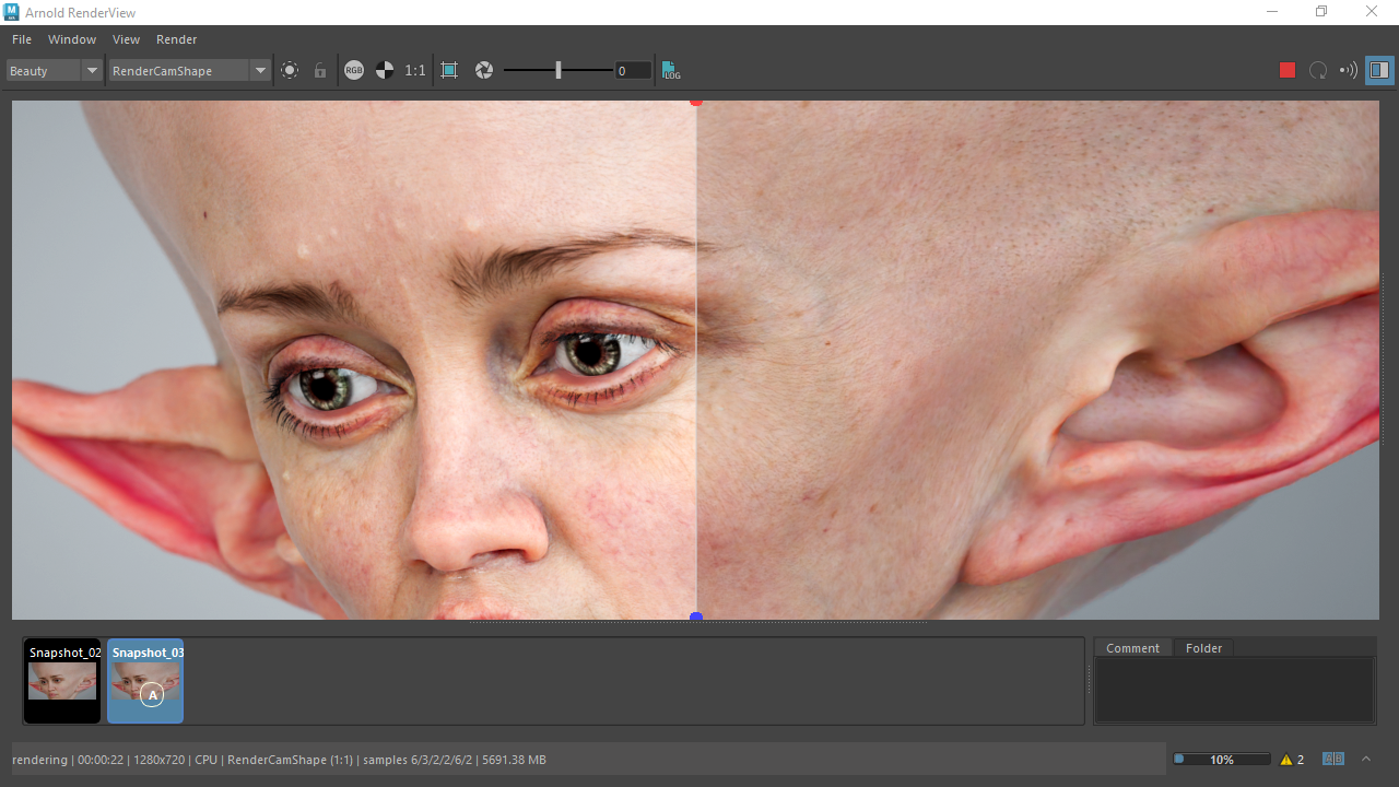

A B Comparison Tool
Allows you to choose between two snapshots to be compared using a wipe tool. Choosing a single snapshot will compare it with the current render.
A/B Comparison tool (right-click snapshots)

Crop Region
This option allows you to perform a region render by dragging an area in the RenderView. Geometry selection in the RenderView will not work when this option is enabled. Clicking in the RenderView window clears the crop region.
You can also drag a region in the RenderView while pressing the SHIFT key to perform a temporary region render.

arnoldRenderView -opt "Crop Region" " 50 50 200 200" // minx miny maxx maxy For the Display Settings, to edit a parameter found in the group "Color Management" one must add the
prefix "Color Management." and for those in the group "Background" the prefix is "Background." So:
arnoldRenderView -opt "Color Management.gamma" "2.2"
arnoldRenderView -opt "Color Management.Tonemap" "OCIO"
arnoldRenderView -opt "Color Management.OCIO File" "/tmp/config.ocio"
arnoldRenderView -opt "Background.BG" "BG Image"
arnoldRenderView -opt "Background.Color" "0.1 0.2 0.4"
arnoldRenderView -opt "Background.Image" "/tmp/image.###.jpg"
arnoldRenderView -opt "Background.Scale" "1.5 1.2"
Note that these functions can be called before opening the RenderView and will be automatically applied later.
