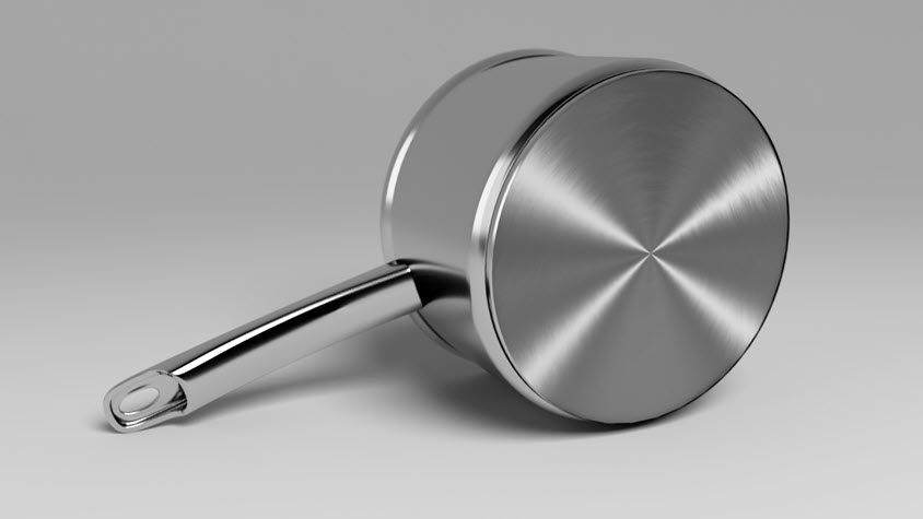

Anisotropic brushed metal effect visible in the base of the pot
This short tutorial will show you how to create a realistic steel shader with anisotropic reflections to create a brushed metal effect on the base of a pot. Anisotropic reflections are based on the orientation of small grooves (bumps, fibers or scratches) that exist on a reflective surface. We will achieve this effect using a combination of a radial ramp connected to the anisotropy and a noise texture connected to the bump map attribute.

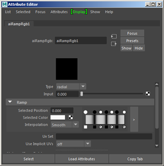

  • Connect a ramp_rgb to the specular_anisotropy parameter.
  • Change the ramp_rgb type to radial. Insert four black and four white colors into the ramp. Change their interpolation to smooth.

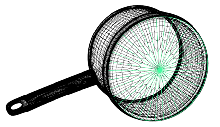

You may notice faceting appears in specular highlights when using anisotropy. It is possible to remove the faceted appearance by enabling smooth_tangents for the Arnold attributes of the mesh. Take into account this requires a subdivision_iteration of at least one in the polymesh to work.
No subdivision_iterations subdivision_iterations: 1 subdivision_iterations: 1 (smooth_tangents enabled)
Note:
The Anisotropic direction is based on the UVs of the mesh you are using.
The Anisotropic brushed metal effect should now be visible at the base of the pot. However, it is lacking the bumped ridges associated with this effect.

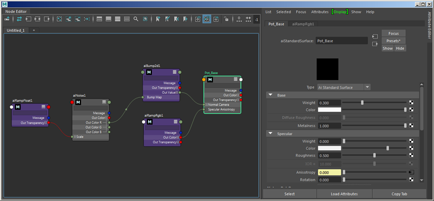

Now we need to create a scratch effect and connect it to the bump attribute to achieve a subtle brushed metal effect. We can do this using the following shaders:
RampFloat -> Noise -> bump2d
  • Create a bump2d and connect it to the normal_camera of the pots base shader. Set the bump_height to around 0.5.
  • Create a noise shader and connect it to the bump_map of the bump2d. Change octaves to 8 and amplitude to around 0.4.
  • Create a rampFloat and connect it to the scale of the noise shader. Change the type to circular. This will give us the concentric ring effect that we want.
