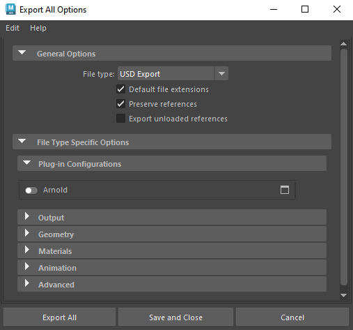

With a version of Maya USD 0.15 or higher, an export option called Plug-in Configuration is available. Switching this option to Arnold will let mayaUSD export all of the necessary Arnold data on top of MayaUSD exports. It will then be possible to render the scene in standalone by running kick scene.usd. Also, loading this file with mayausd as a proxy shape or through an aiStandIn will allow to render it on top of another scene.
Known limitations:
Importing such a USD file to Maya won't import all the Arnold data back to Maya.
In order to kick the export USD file, it is necessary to create a camera so that MayaUSD exports it. The default "persp" camera will be ignored by mayaUSD.
Note that if you don't see the "Arnold" in the "Plug-in Configuration" list, it means that you don't have a version of MtoA that is compatible with the installed version of MayaUSD.

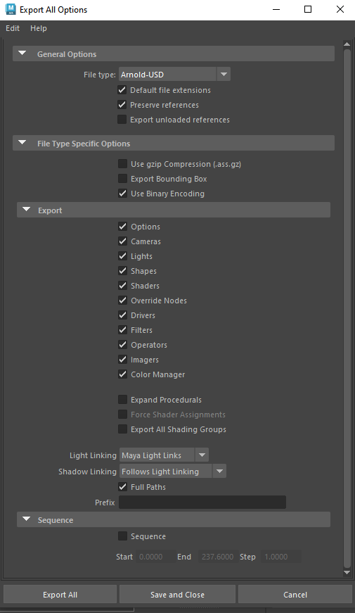

- To export the scene/selection as a .usd file go to Arnold -> Scene Export -> Export All/Selection to USD ..

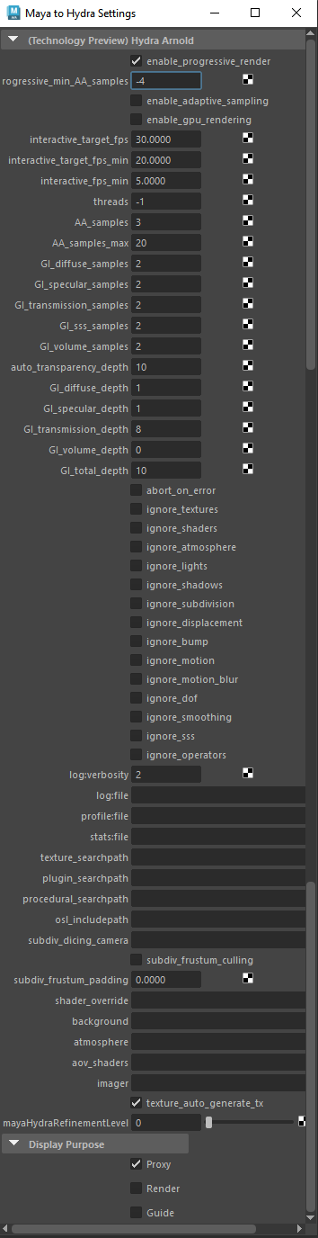

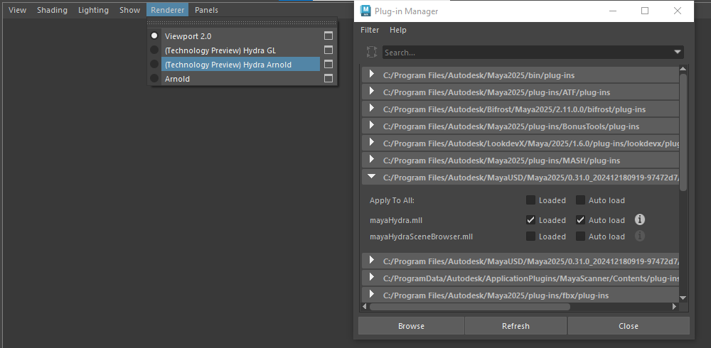

In Maya USD there is also a plugin called mtoh.mll (Maya to Hydra). This allows you to enable the Arnold (Hydra) viewer in the viewport.
Maya to Hydra settings:
Hydra
Uses Hydra to handle the translation of USD to Arnold, which makes the render consistent with the Hydra render delegate.

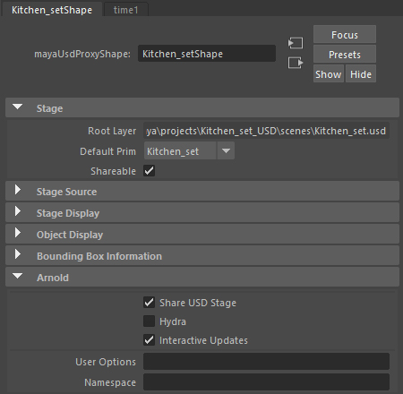

Maya USD Proxy Shape
The usdProxyShape object has an Arnold section in the Attribute Editor. The Hydra attribute allows you to render through the Hydra framework, and use Hydra generative procedurals.
Hydra parameter exposed in the mayaUSD proxy shape
