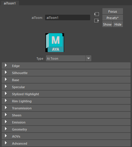

See Toon in the Arnold User Guide for the full shader documentation.
The toon shader is part of a non-photorealistic rendering (NPR) solution that is provided in combination with the contour_filter.
  • The Contour Filter can be found in the Filter settings of the Render Settings window.
  • When adding bump to the Edge, you should also change the Edge Detection to Shading Normal.

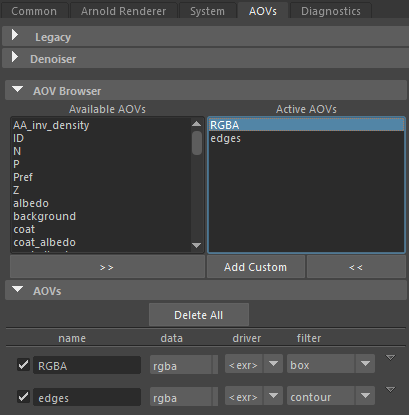

RGBA (box_filter) and edges custom AOV (contour_filter)

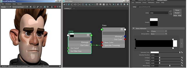

Ramp -> specular_tonemap

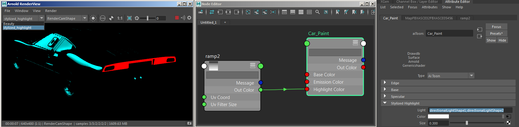

Multiple (blue and red) lights used for Stylized Highlight - 'directionalLightShape1;directionalLightShape2'.

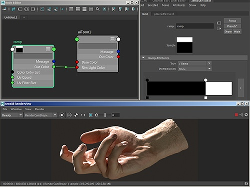

Directional light used for rim_lighting
