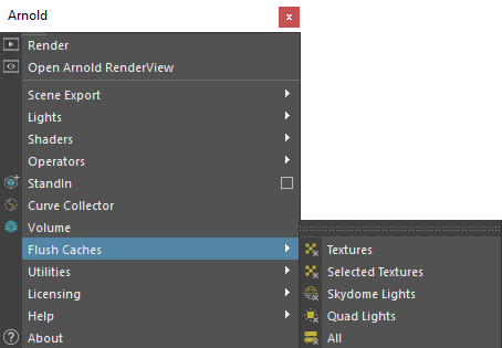

Flushing Caches
The Flush Caches menu can be found within the Arnold menubar in the main application window

Selected Textures
Only flushes the selected textures.
Skydome lights
Flush all textures assigned to a skydome light.
Quad lights
Flush all textures assigned to a quad light.
All
Flush all texture caches in the scene, including normal, skydome and quad light textures.

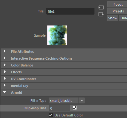

Mip-Mapping Bias
Mip-Mapping Bias offsets the Mip-Map level from which a texture is sampled. Negative values indicate a larger Mip-Map level (bigger texture); a positive value indicates a smaller Mip-Map level (smaller texture). This is evident at the top of the images below:

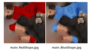

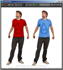

shapeName
The texture token <shapeName> provides a direct connection between the name of the mesh and the texture name, replacing the name of the 'shape' at render time.
Here's an example shapeName workflow:
Rename the textures to:
- Add main_<shapename>.jpg to the image name of the file texture that is assigned to both meshes in Maya.
- Rename the meshes to 'Red' and 'Blue' and the textures will automatically be replaced.
