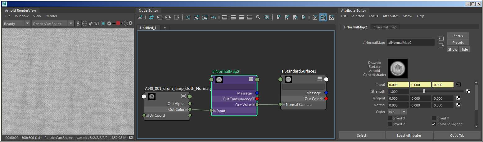

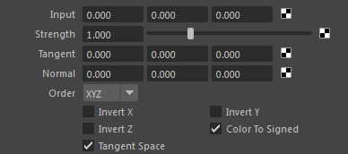

Normal mapping works by replacing the interpolated surface normal by the one evaluated from an RGB texture, where each channel (Red, Green, Blue) corresponds to the X, Y and Z coordinates of the surface normal. It can be faster than bump mapping since bump mapping requires evaluating the shader underneath at least three times.
normal_map -> standard_surface
