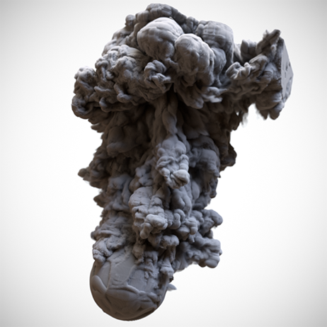

Standard Volume
Assign a standard_volume shader to the volume.

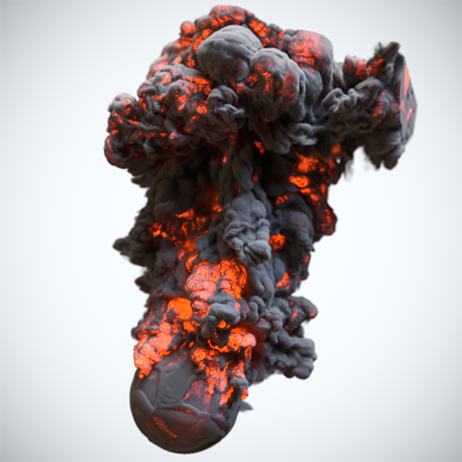

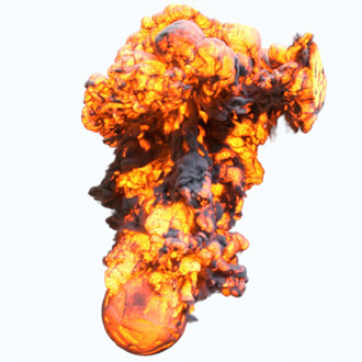

Render the scene. It should look like the following image.

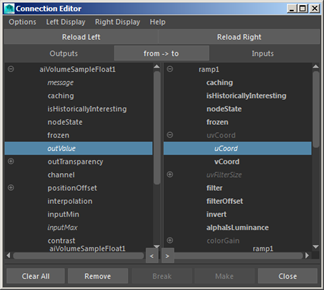

- Create a Volume Sample Float shader and drag and drop it onto the U attribute of the UV Coord as indicated in the image below.
Volume Sample Float shader connected to Uv Coord (U) attribute
- The Connection Editor will open. Connect the outValue of the Volume Sample Float to the uCoord of the ramp.
- Select the Volume Sample Float shader and add density to the Channel attribute.

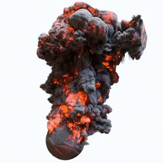

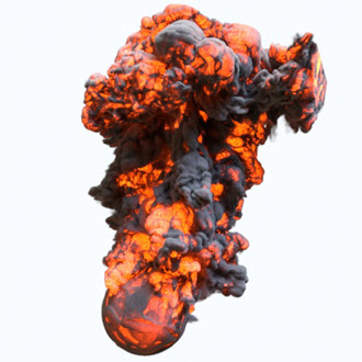

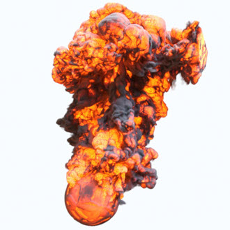

Emission
100 | 1000 |
Volume Sample Float Attributes

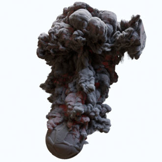

We can use the Volume Sample Float shader to alter the appearance of the fire. The following images show different adjustment attributes and their effect on the fire volume.
Input Max
1 | 2 | 3 |
Bias
0.92 | 0.95 | 0.97 |
Gain
0.1 | 0.2 | 0.3 |
Output Max
0.5 | 0.6 | 0.7 |
