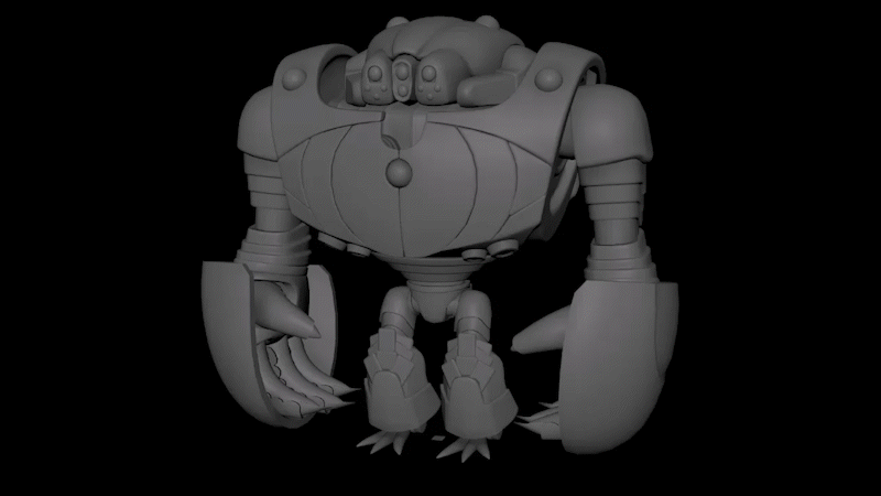

Traditional bevel (left) compared to Smart Bevel (right)
Use after Boolean operations
Smart Bevel works well after Boolean operations, which create intersecting meshes. Intersecting meshes often create dense and uneven geometry that can be difficult to bevel cleanly. Smart Bevel generates a more predictable blend at Boolean intersections and helps you achieve smooth transitions. This reduces the need for manual cleanup.
