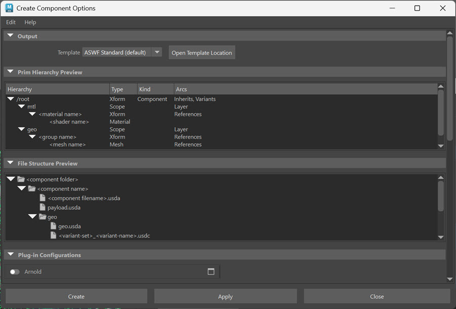

Component Creator Options
To understand how your components will be structured, or to set a custom template file, open the Component Creator options dialog by clicking the options box at the Create Component menu.
Output
Template Specifies the JSON template used to structure the resulting USD asset (ASWF standard by default). You can click Open Template Location to quickly navigate to the template file's location on disk.

Prim Hierarchy Preview
Displays a generalized version of the prim hierarchy according to the template.
File Structure Preview
Displays a generalized version of the USD file structure on disk according to the template.
